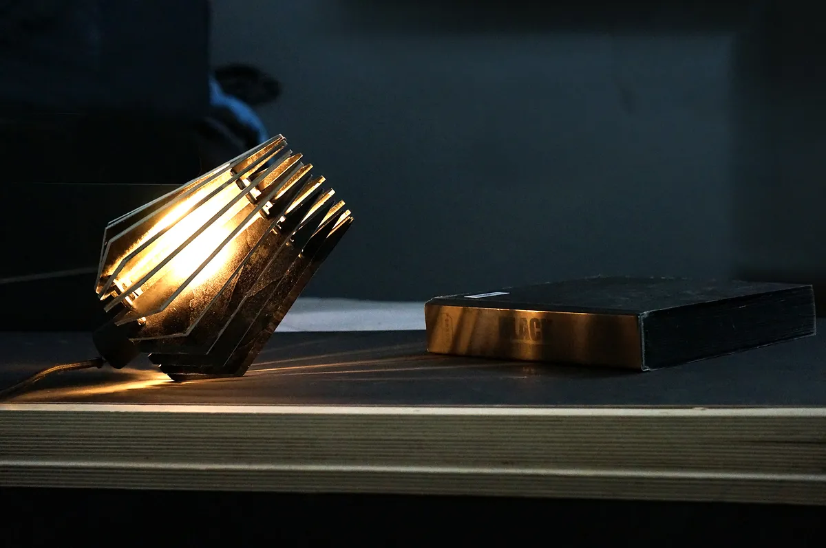

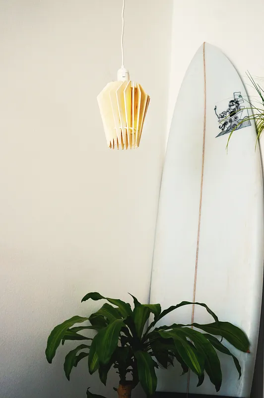

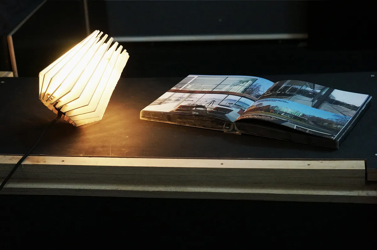

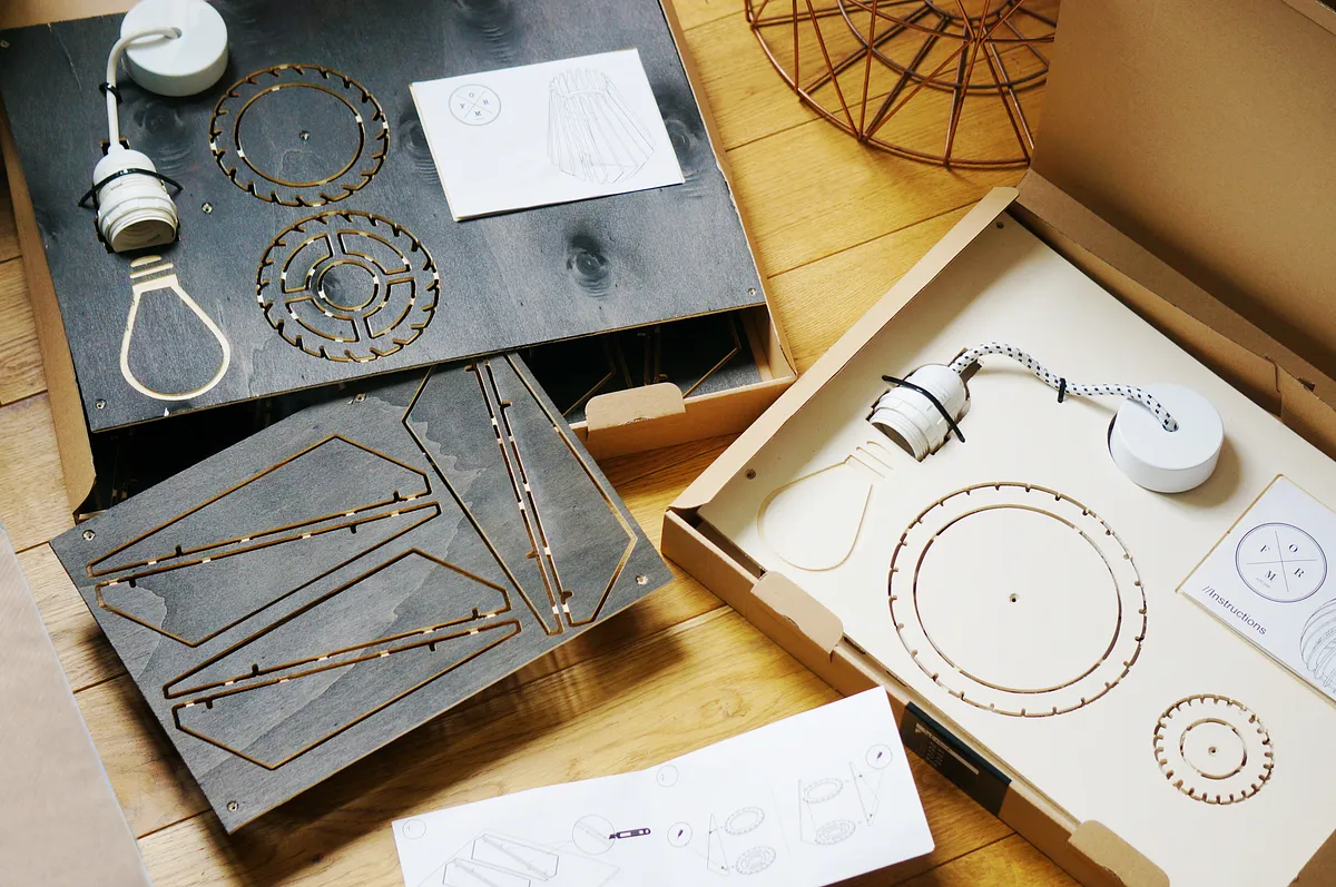

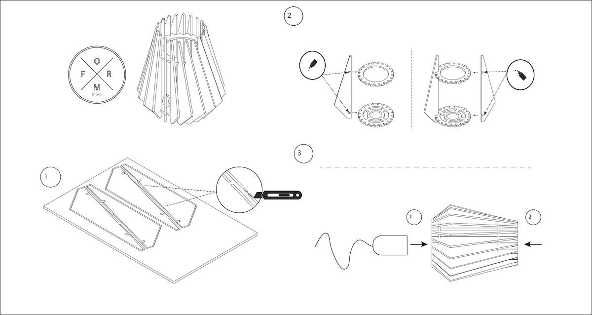

Shade Lamp Its a simple but exciting lamp carved out of 3,7mm thick plywood. I used a 3mm flat downcut endmill. The recomended Speeds are a bit low , I can cut this in under 30 min.
The desing is optimized to use DIN format plywood that you can get everywere. (at least in Germany )

hmm, it looks like there happened something with the project... there is a circle in the second sheet but the lower "base-part" is missing.
