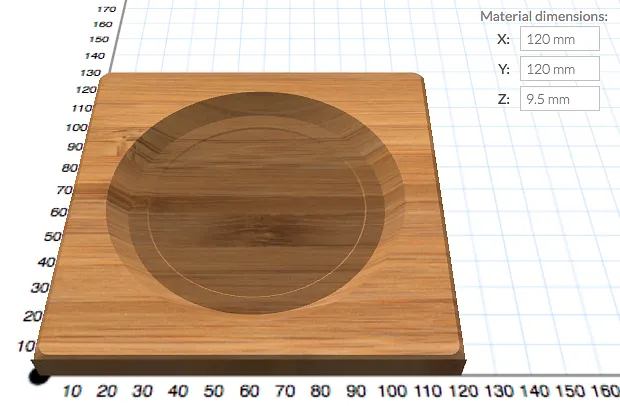

Once you receive your bamboo blank from the Bill of Materials, use a scroll saw or other saw to cut the blank to 120mm X 120mm.
Secure the newly cut stock into your X-Carve at the Origin (0,0). Make sure to be precise since a chamfer is cut around the perimeter of the soap dispenser base to give it a nice finish.
Follow the link to my Easel project to carve the flask base. G-Code is provided in the digital files for your convenience as well.

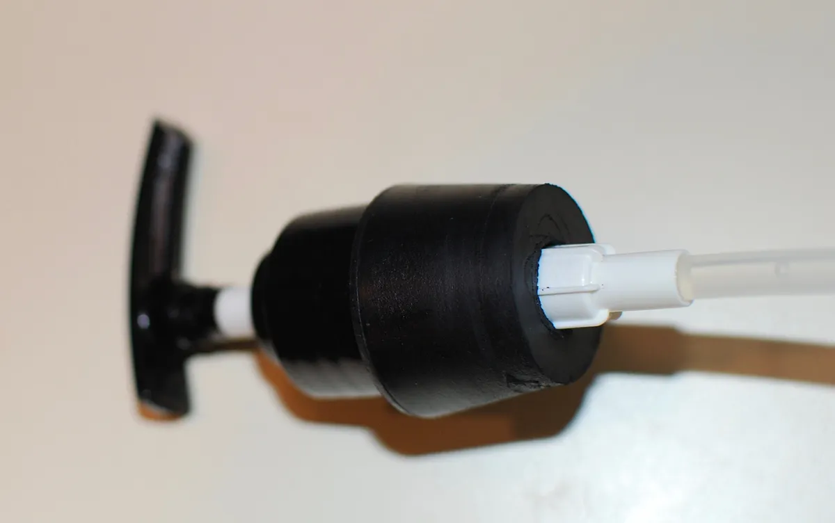

Final assembly of your masterpiece may require some last minute craftsmanship depending on the size of the soap dispenser's suction tube. Don't be afraid to make it your own and have fun creating! Take a look at the photo to get a general idea for how the rubber stopper should be cut when you're done.

Drill the rubber stopper through the middle using a drill or drill press. Make sure to measure the outer diameter of the suction tube before beginning, and progressively drill the hole through the center of the stopper using larger and larger bit diameters until you reach the proper size. It is imperative that you secure the rubber stopper while drilling. Rubber is very sticky and will want to move around when you start drilling, which could be dangerous. A drill press will make this step much easier.

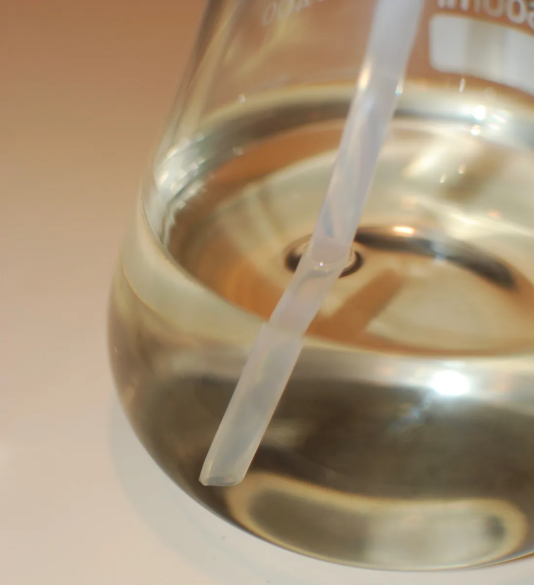

Cut pump's suction tube to length. It may take a few test fittings to get things just right. I recommend cutting the tip at a slight angle (like cutting flower stems) and leave it a little bit long so that it curves toward the edge of the inside of the flask to get every last drop of soap.

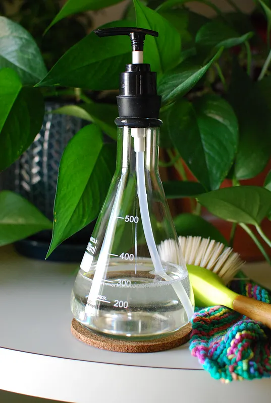

Place the soap dispenser flask assembly in the base and place near your favorite sink!
