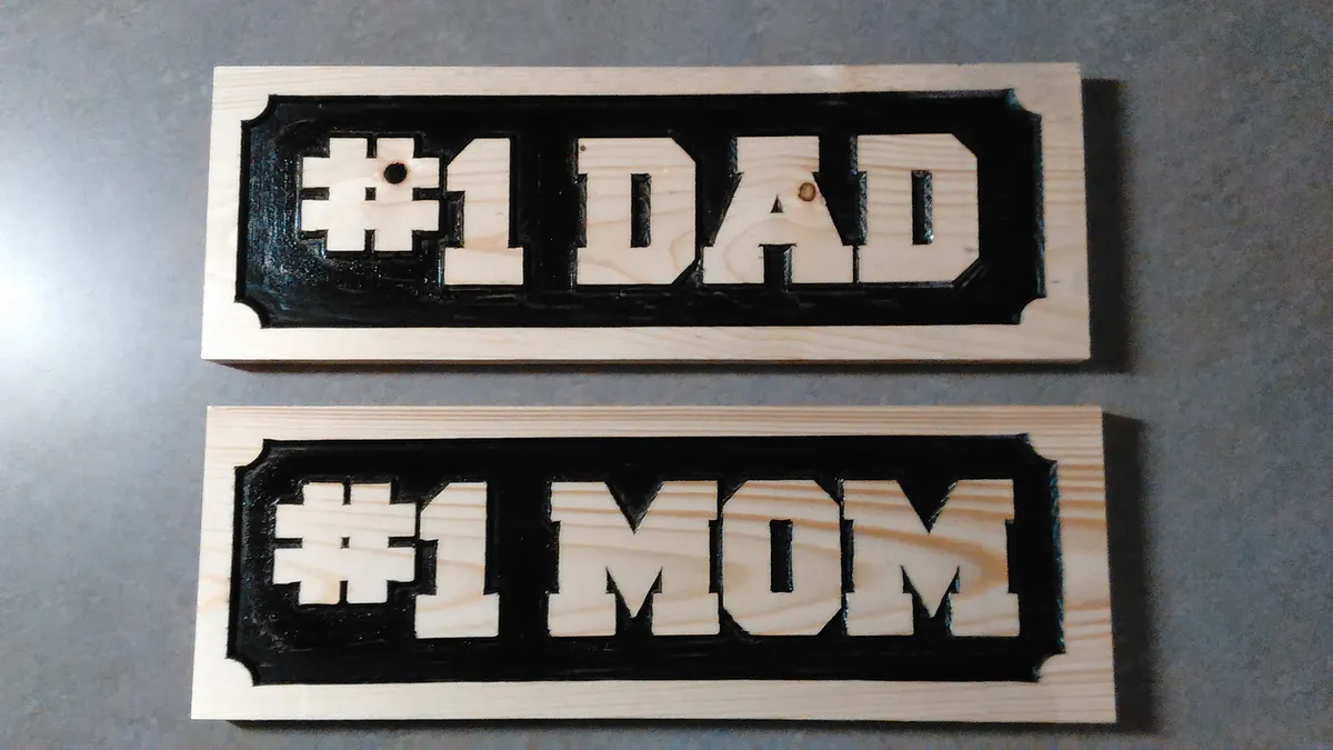

Can you share what Bit you used and also board thickness please? Thanks as this is something my son would like to try and make on our CNC.
Mark Cooper · June 05, 2018
I used a 90 Degree V bit for the #1 DAD and a .25 End Mill to clear the surrounding. It was designed using Vcarve Desktop and the G-Code through Easel. Feel free to ask me anything you'd like.
