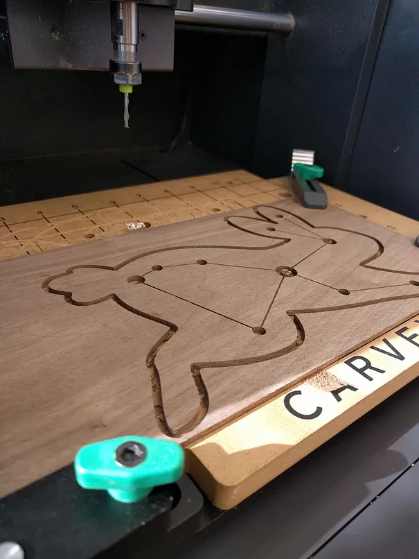

h3. Front piece (6 minutes)
Material: 1/8" walnut Workpieces: "Front piece: 1st cut", "Front piece: 2nd cut"
Clamp the first sheet of 6 x 12", 1/8" walnut to the machine. Carve the constellation lines, "Front piece: 1st cut" to begin, using a 1/32" downcut fish tail bit. I used the recommended settings for the 1/32" upcut bit. (2 minutes) Leave the piece clamped. Swap in the 1/8" downcut bit and carve the holes for the stars and the outline of the rabbit: "Front piece: 2nd cut". (4 minutes)

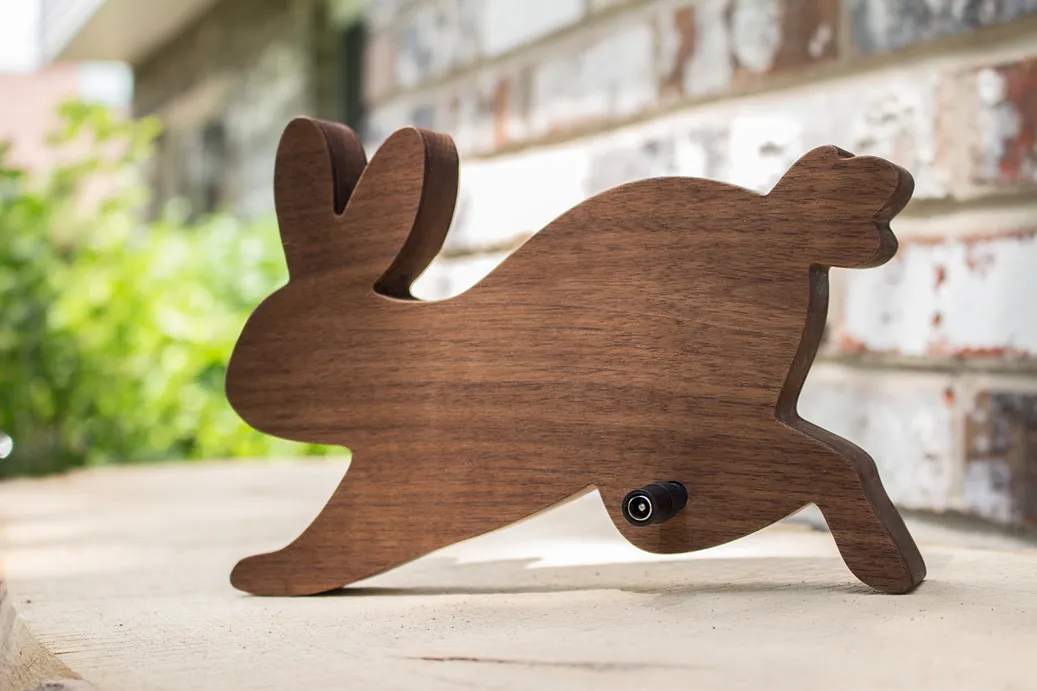

Using a fresh sheet of walnut, carve "Back piece" with the 1/8" downcut bit. I used settings for the 1/8" upcut bit. Note: The circle located on the back leg of the rabbit is an exit hole for the light cord. If you're using a different cord, you may need to modify the hole's diameter.

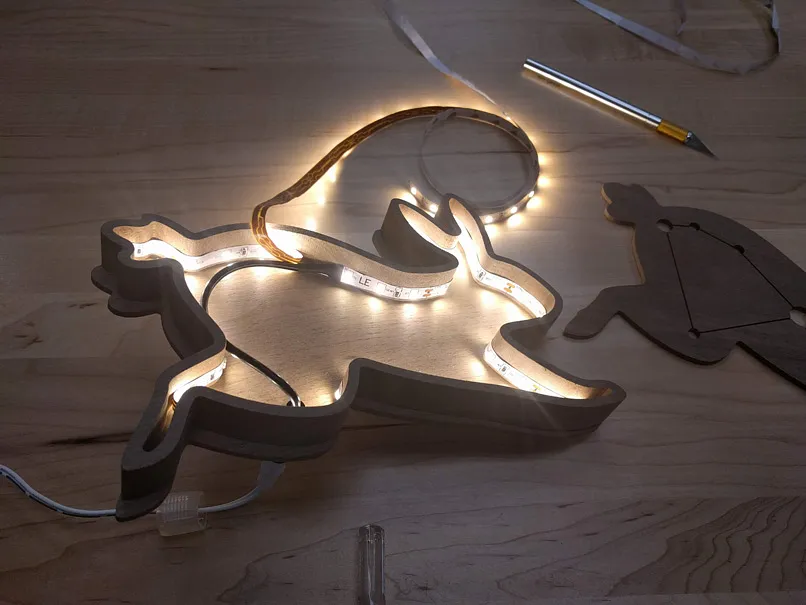

Add LED lights
You will need about 1 yard of the flexible, self-adhesive LED strip lights. Unroll and cut off a piece which is a few inches longer than this.
Stack the body piece on top of the back piece, so the rabbit's head is facing right.
Feed the cut end of the LED strip from the back through the hole in the rabbit's leg.
Removing the backing paper as you go, stick the LED strip to the sides along the inner perimeter of the body piece. In order to leave clearance for the light diffusing pieces, try to keep the LED strip in the middle of the body or lower, closer to the back piece.
Note: It's fine if you're not be able to get the LED strip into the tightest corners—the tips of ears or feet. Just make sure the lights are placed so they'll shine through the cutouts in the front piece.
Estimated time: 10 minutes

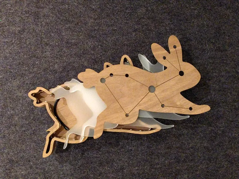

See the image below to see how the pieces stack together.
Attach back
Glue the back piece to the body piece with wood glue.
Add the light diffusing panels.
The light diffusing panels should fit snugly inside the body piece if the tolerances are right (they may differ slightly on your machine). Press fit each piece into the top of the body, with the frosted/matte sides facing up. If the fit is too loose, you can glue the two pieces to each other and then to the front piece.
Attach front
Attach the front piece to the body with wood glue.

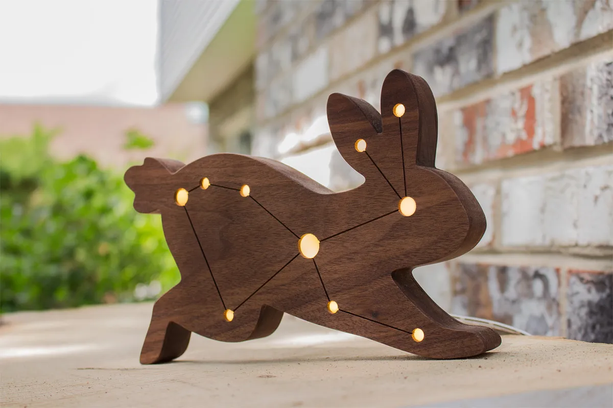

Sand and coat with the finish of your choice. I used mineral oil, but a wax-and-oil combination would also look great.
Enjoy the celestial hare in the daylight and by the glow of the stars at night!
