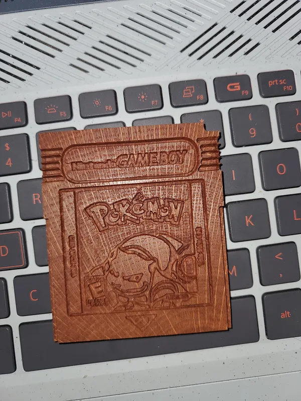

Gameboy Cartridge
This was done on 1/4 Scrap Hardwood 3 1/2 by 3 1/2
It is cut using a 1/8 in upcut mill for Rough Cut
Then went in with 15 Degree V Cut Bit for details
Once all that is done go to layer 2 and use a 1/4 Mill to cut it out don't Re Zero XY use same XY as before
