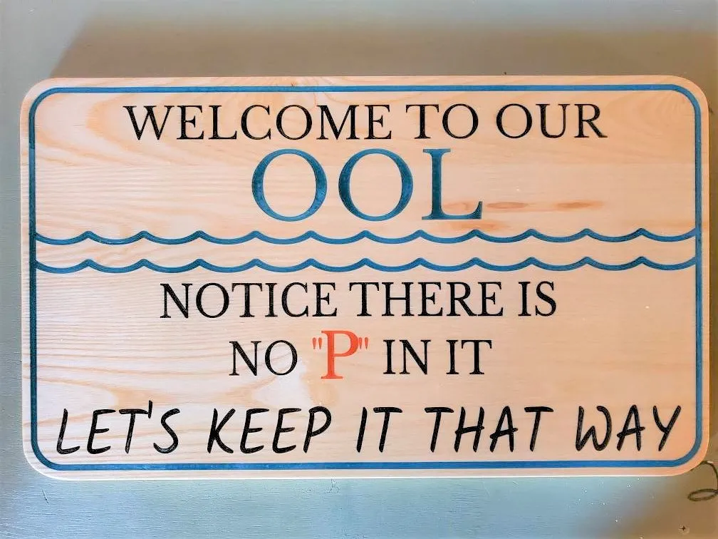

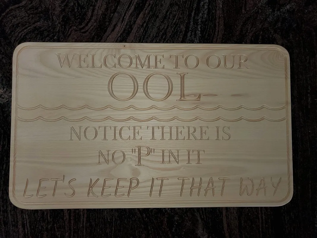

Carved in 24 x 14 Ash with 60 degree V-bit. Then filled with colored epoxy and clear coated to stand up to the pool environment. Created and carved entirely in Easel. Waves are from the design library, fonts are from the PRO selections.
