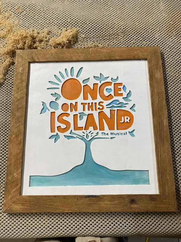

A sign I made for my kid who had a nice part in the Middle School musical Once on This Island Jr.
1/4" MDF carved with a 1/8" straight bit & 60 deg v-bit detail. I painted the infill with a brush and blended acrylics, with white latex rolled on the field. The frame is reclaimed oak pallet wood.
x-carve 2016
MDF
