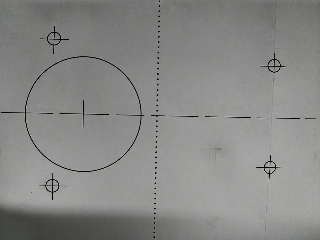

Template for Full Overlay Frame less Hinges with 110 degree opening. Arrows show the respective edges. The tiny hole is used to align both templates. One for the Door, and one for the side panel to hang the door onto.
