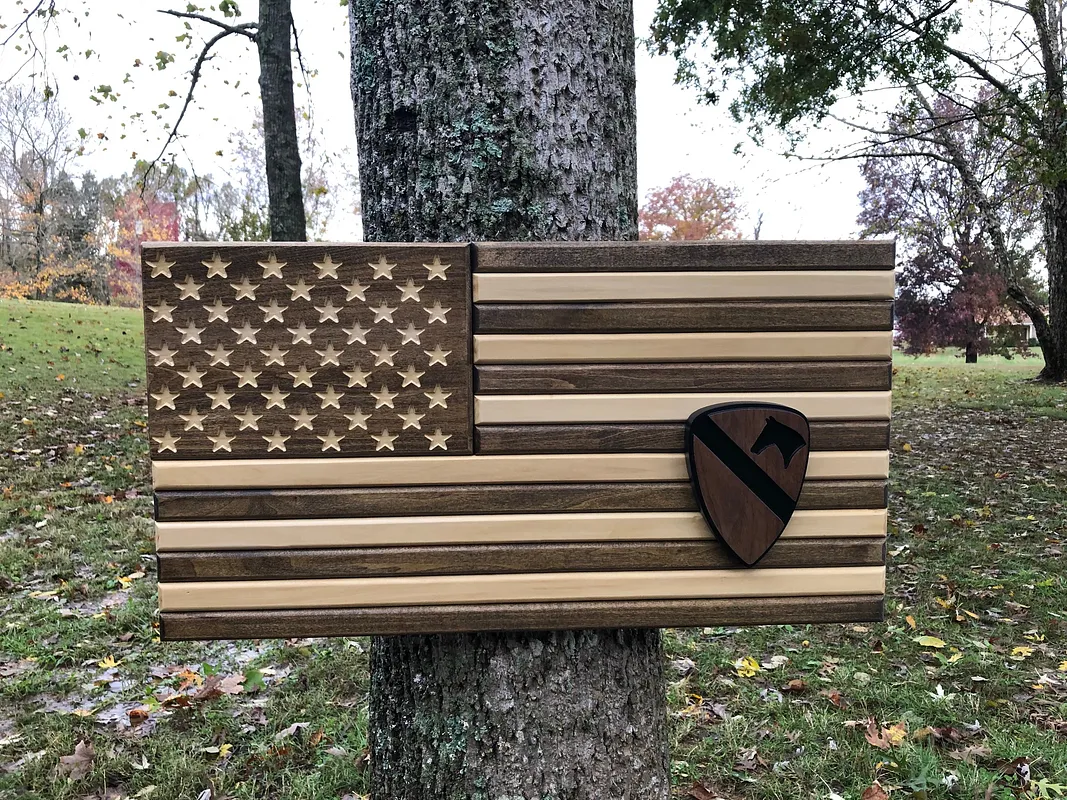

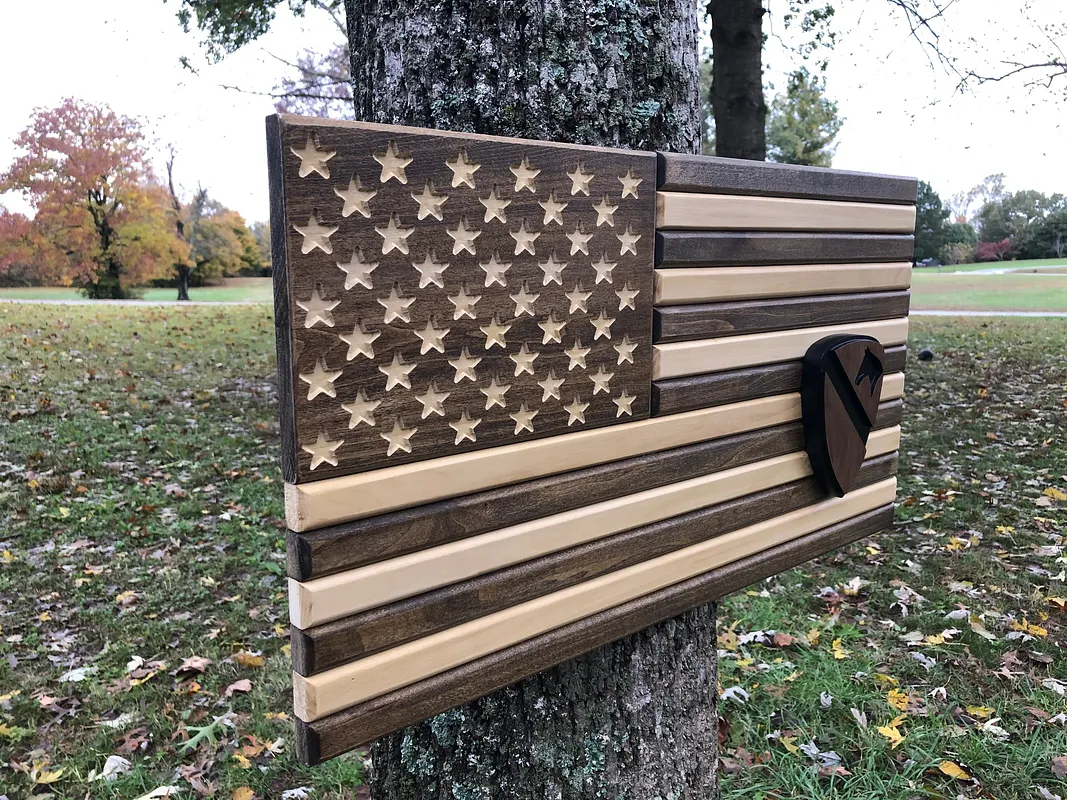

I created this flag for my father. I wanted it be different than the other flags out there and have more 3D feel to it. Stars were cut via X-carve as well as the 1st Air Cav patch.
I fixed the link in Easel, sorry.

quick question. in your pics the stripes seem to be individual strips but in easel it looks like the stripes are carved. whick is it carved or individual strips? Thanks
Chuck Pierce · March 21, 2023

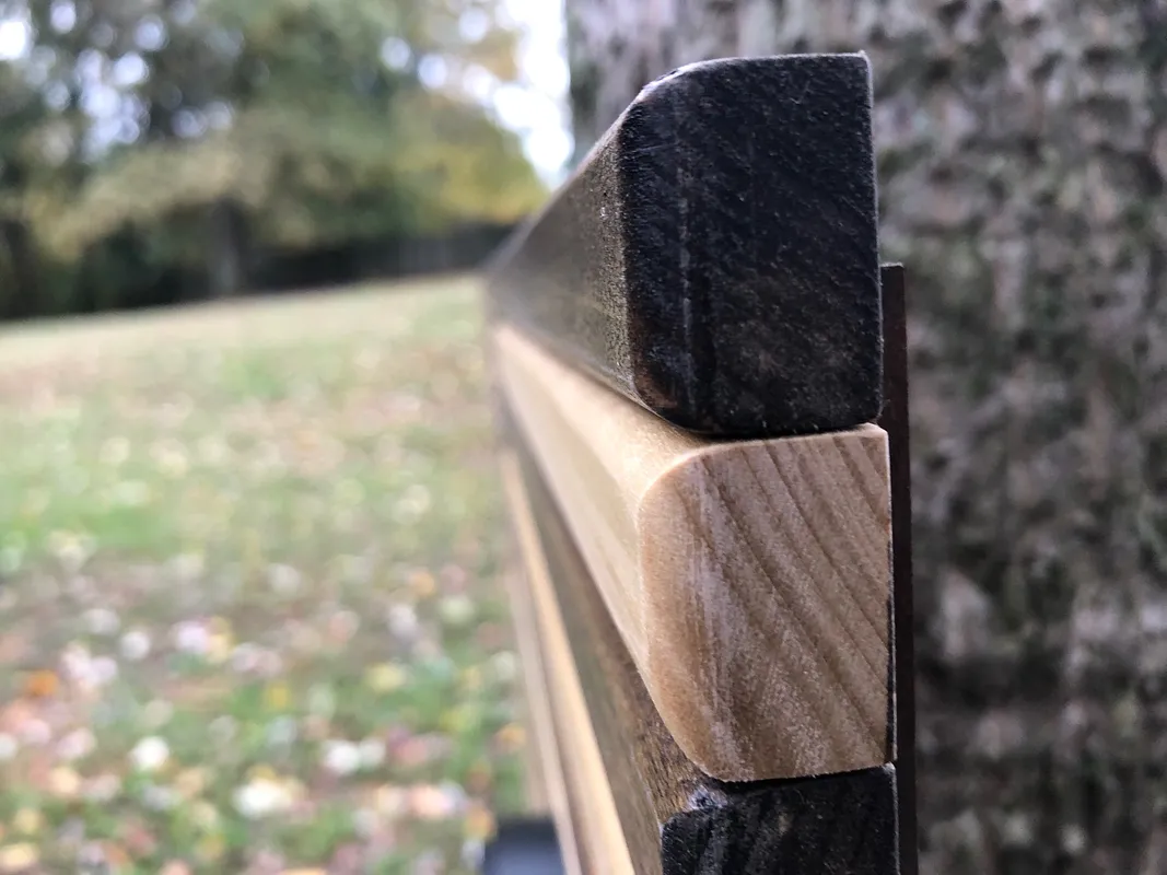

The stripes are cut out separately pieces. I did the mock up in Easel for alignment and to make sure everything would fit to the proportions I wanted. After the groves were cut in Easel I cut the stripes out with a table saw and beveled the edges to give it a more 3D feel.
