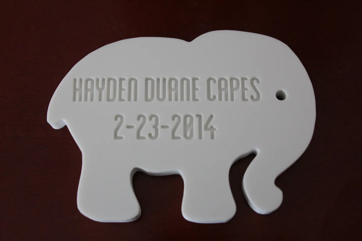

Joshua, I can't remember exactly what I used, but in general you would probably want to be somewhere in the range of 1/16" depth per pass at 30" / minute feed rate. It will depend on what bit size you are using and what kind of spindle you have, so you may want to adjust this based on your setup.

Do you recall what your milling speeds were and what cutout tool you were using?
joshua blom · March 27, 2015
Royce, I believe I just used an image from a google image search for "Elephant"
Jeff TalbotPro · March 27, 2015
