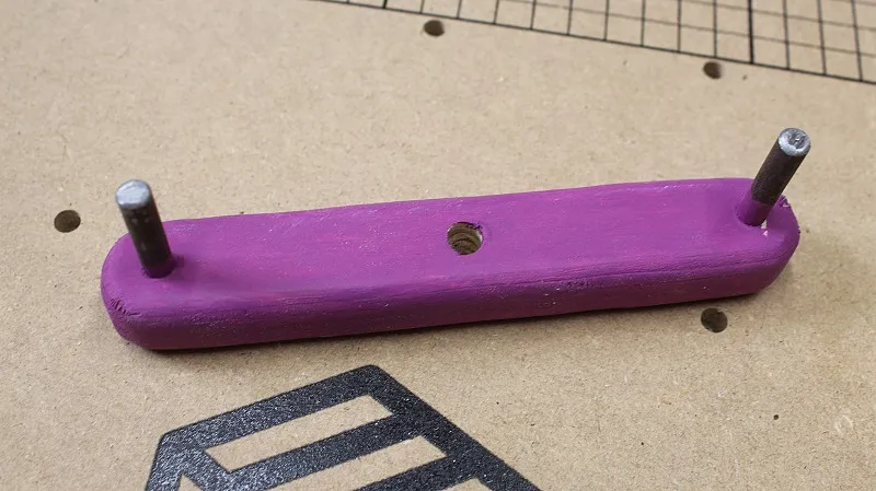

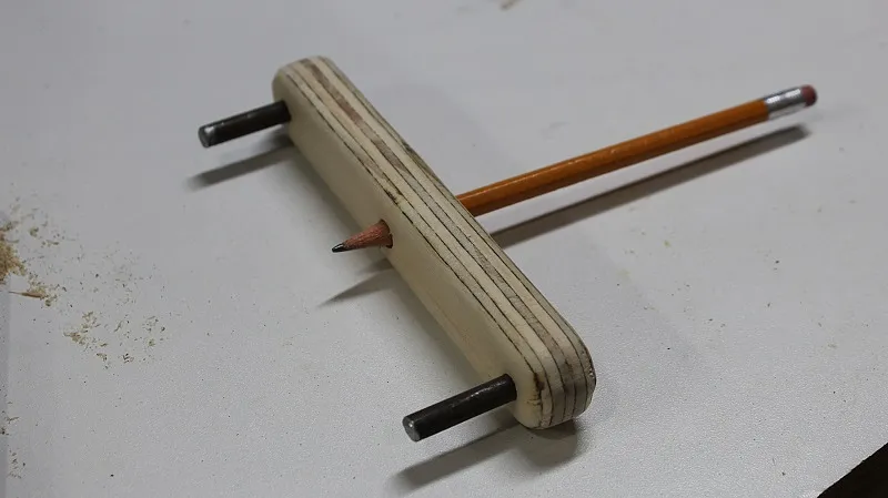

Finish tool with dowels or round bar
Cut two 1-1/2" long, 1/4" diameter wood dowels or steel round bar. Insert the dowels in the holes on each end of the tool body. A pencil goes through the center hole when ready to use. Finish body with sand paper, paint, or other finish if desired. Begin using tool.
