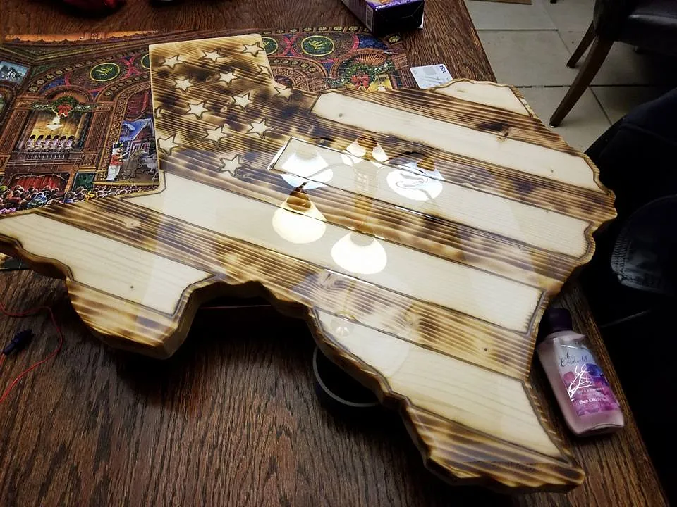

What size bit was used. I have some Texan relatives that would be tickled with it.
Gary Donaldson · August 04, 2018
1/16 down cut to outline , or a 90 vbit if i cut the stars out completely.

Michael RomoPro · December 05, 2025
I basically overlapped a flag engraving over a texas shape cut. I did a white out of the extra flag on the outside of the texas shape. Used a 1/16 down cut bit. Burnt the wood before cutting.
