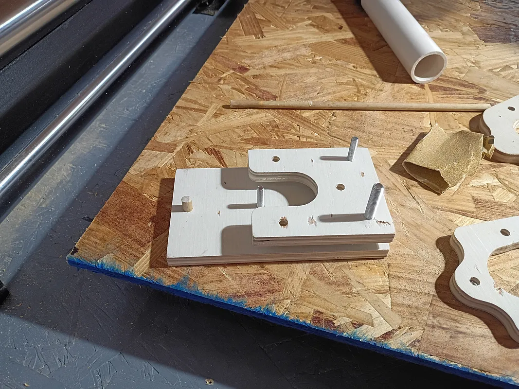

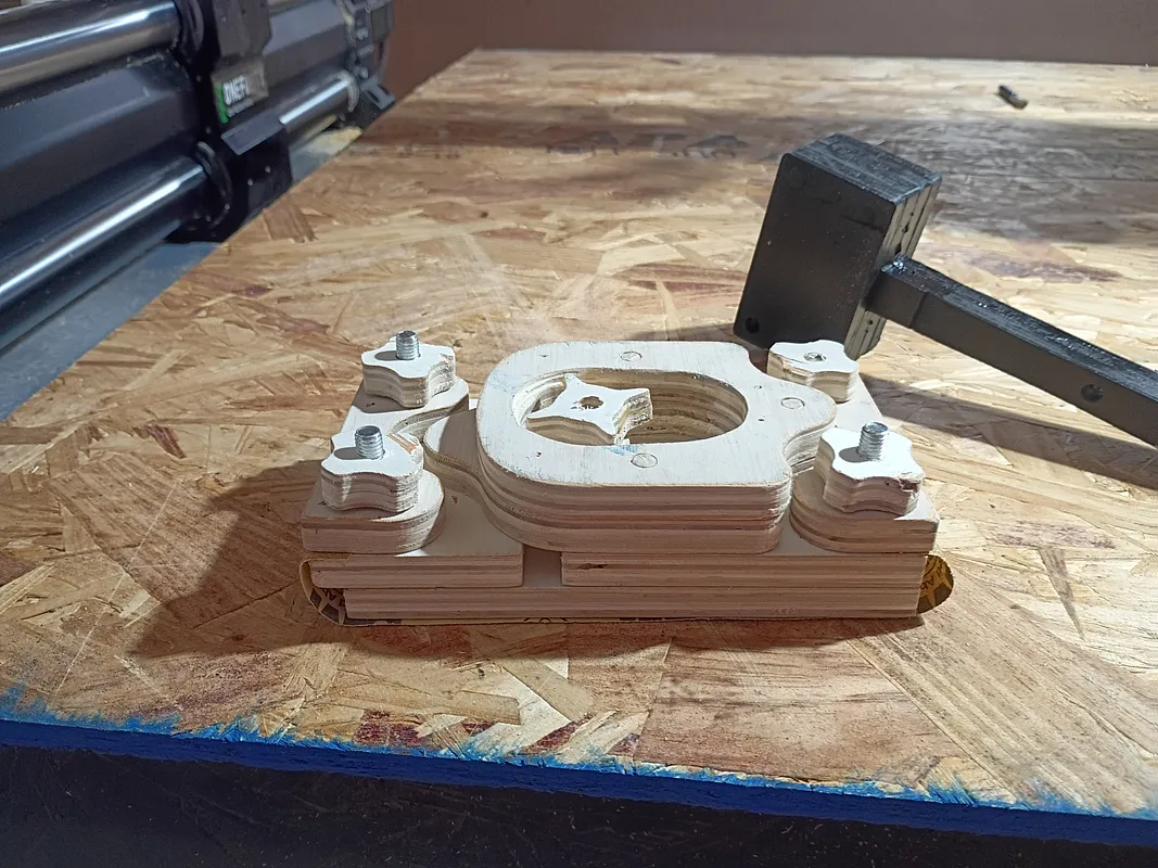

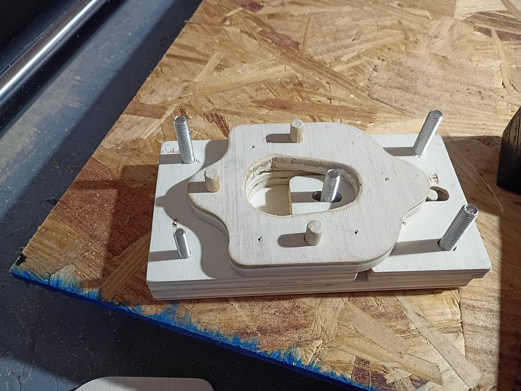

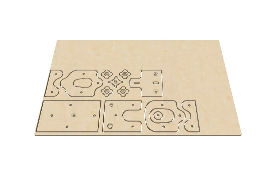

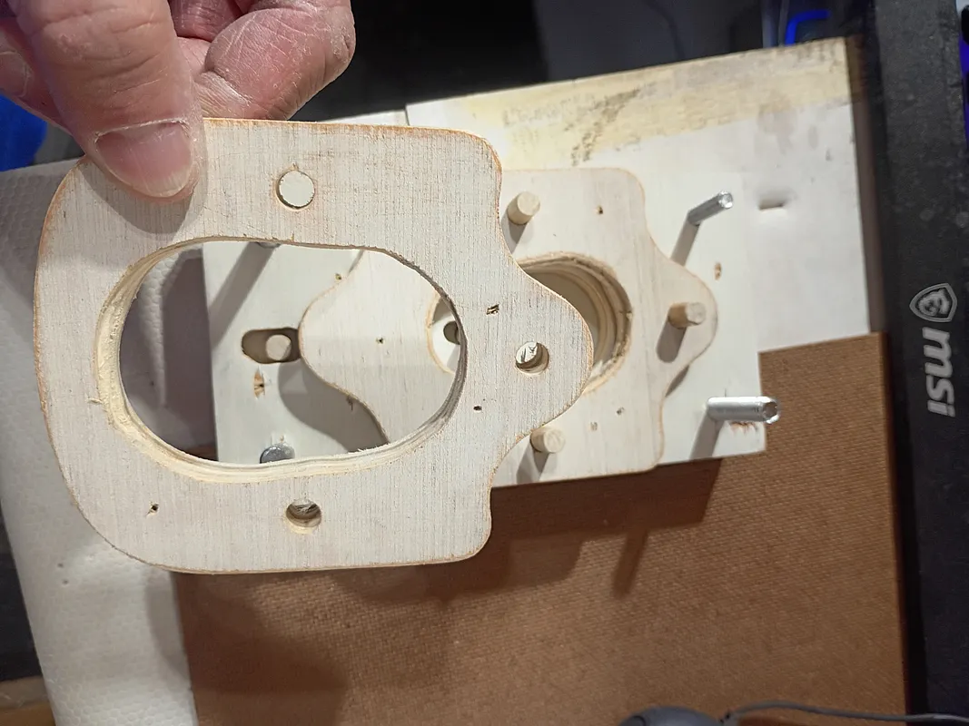

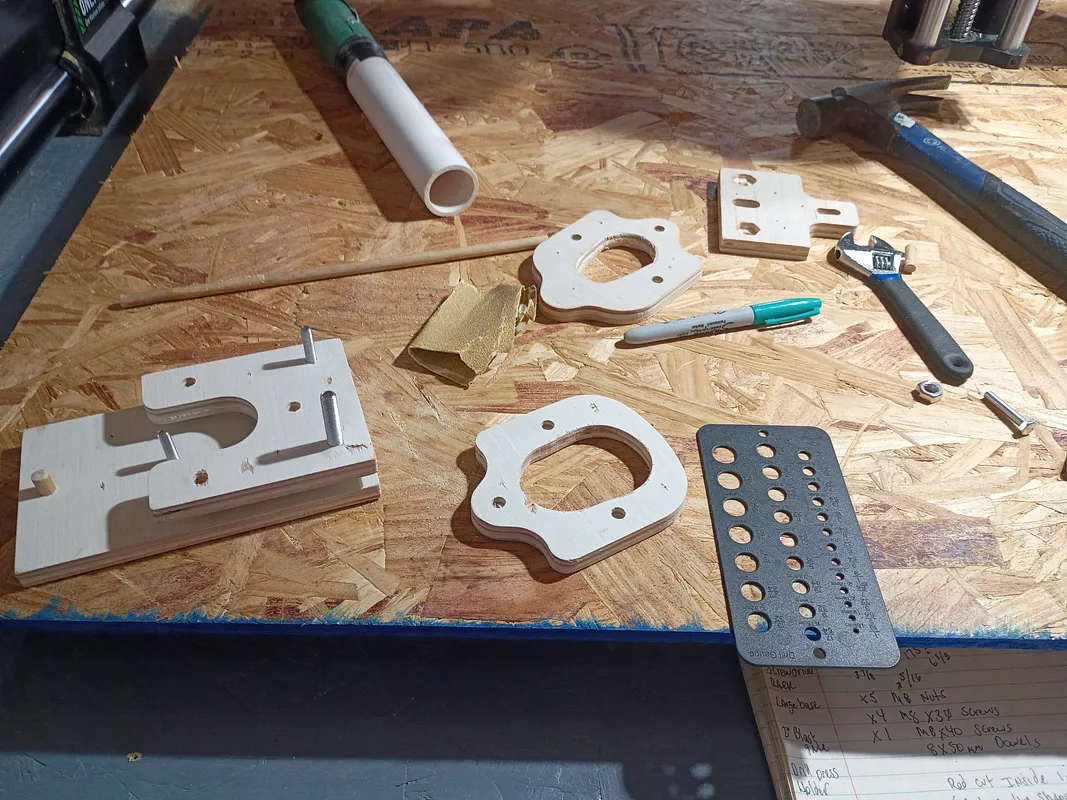

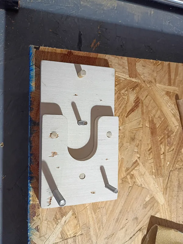

A nice sanding block when you don't want to use palm sander.
Notes
The knobs i used my drill press with 5/16 drill bit.
I used (3) 2" dowels and (1) 1" dowel and (5) M8 BOLTS BY 1 1/4 LONG AND NUTS
