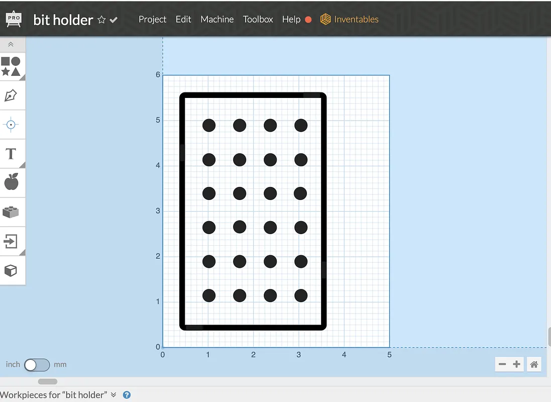

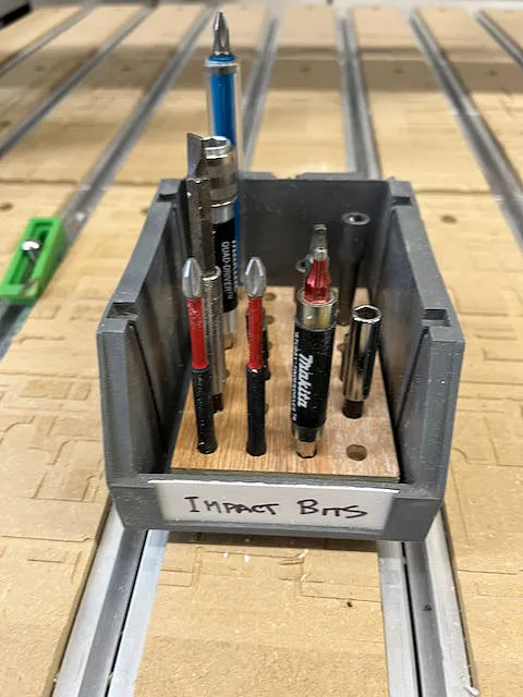

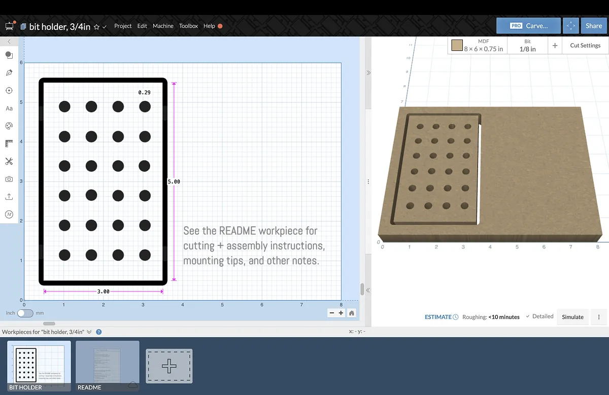

- Hole size is 0.29", determined by testing for common driver bits.
- Cut from MDF or 3/4" plywood; final outer size depends on your storage bin.

It is important to note that the hole size is 0.29 inch, each.
This was determined by trial and error.

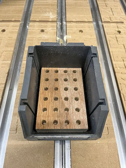

The overall size of the piece will be determined by your plastic box.
I did trim this slightly on the table-saw for a better fit.
