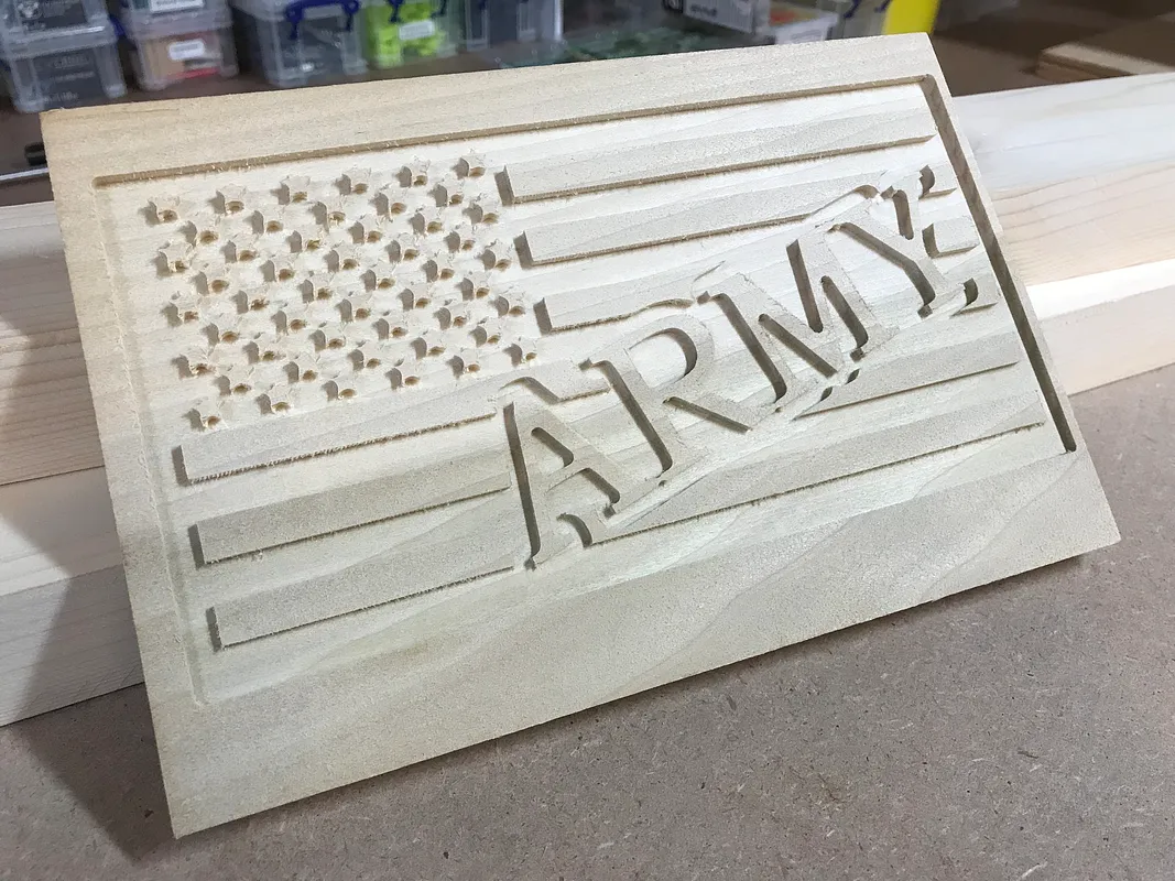

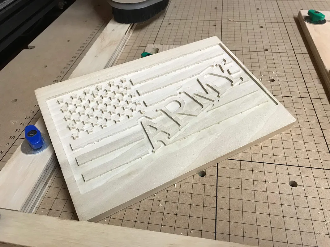

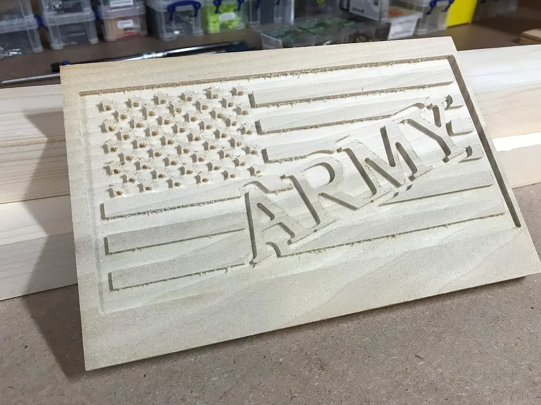

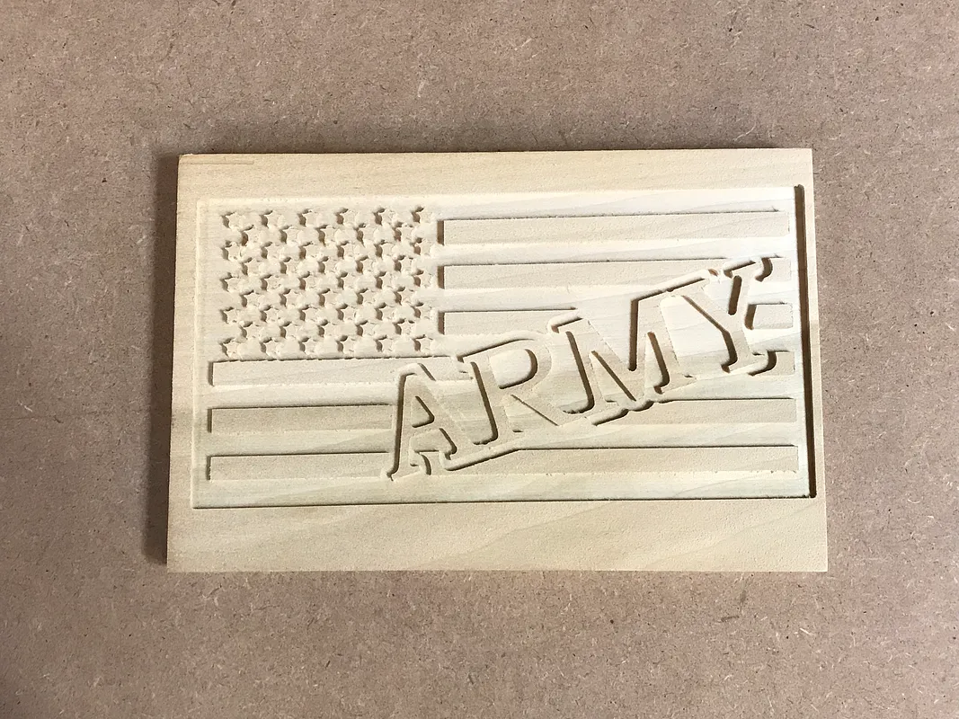

A practice run with a new American Flag Graphic I picked up this weekend. It's only 8" by 5.5"...but I can upscale it when I'm ready for a bigger carve. I did it on 1/2" Poplar with a 1/8" downward spiral bit. It took a little over an hour to carve. I used V-Carve Pro for my Software.

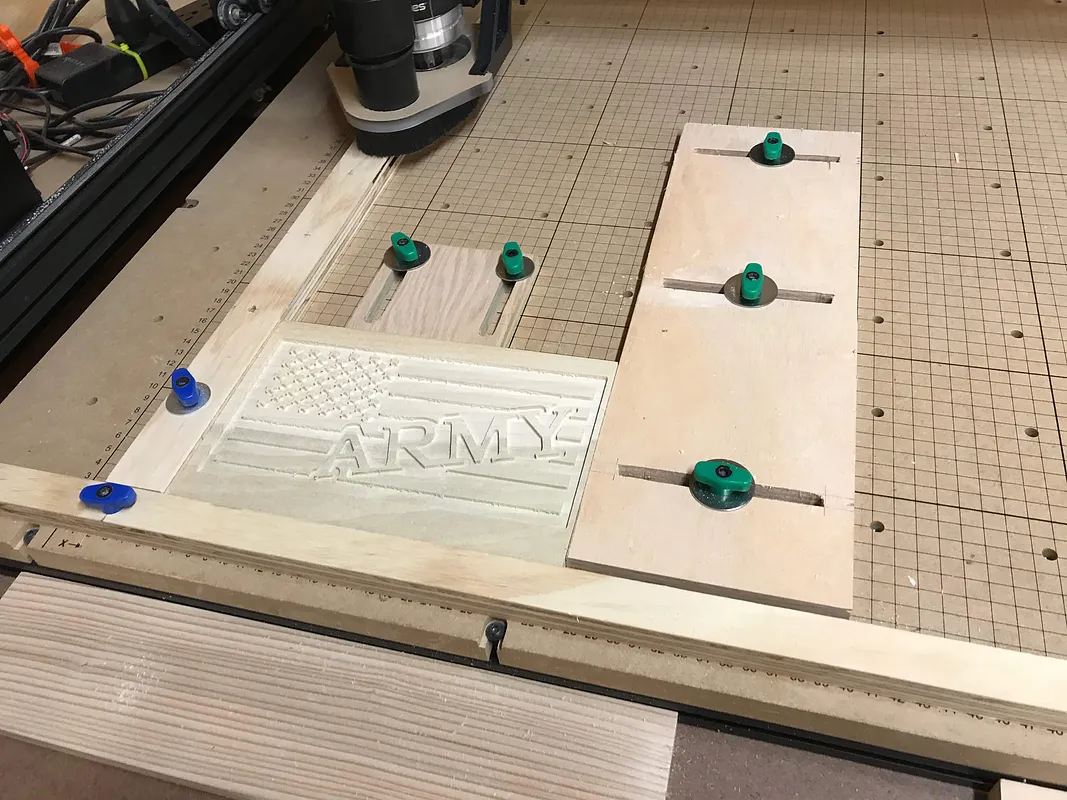

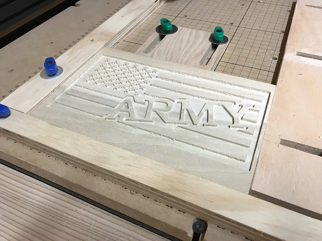

Can you tell me what you used for you guide boards? I am looking into doing this for my students so they get a more secure piece! Thanks!
Adam TheerPro · October 13, 2021
Morgan, This is one of my first pieces I ever did, so it is not as polished as some of the work I do now. As for guide boards...I'm not sure what you mean by guide boards. I just set it up on my Inventables X-Carve, clamped it down with the plastic clamps they sell and carved.
