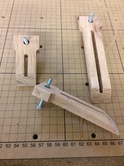

3", 4.5", and 6" Clamps. The 3" is handy for clamping the left side. The 6" is handy for clamping diagonal. Holes are for a 5mm threaded insert. I used a piece of scrap 5"x10" oak.
did you just sand the ends?
Martin GutzmerPro · September 22, 2018
Yes. I just used my bench sander on the ends to put a bevel on it.
