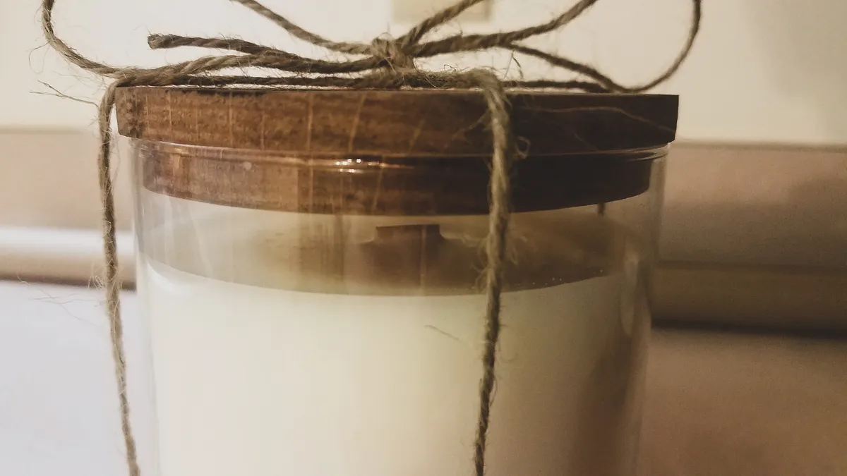

I purchased a few cases of these Libbey 853 glass containers from JarStore.com to use as containers for candles I made as Christmas gifts. They have pretty excellent customer support, by the way. I believe the sell lids for these, but I wanted to make my own so I could customize them, plus I like the look of wood lids.
Anyway, for this project I had some 4/4 White Oak boards that had been planed down and joined. In short, I was using some random-sized wood. This file is easy to customize though, and you can make these lids out of any material that's about 3/4" or larger.

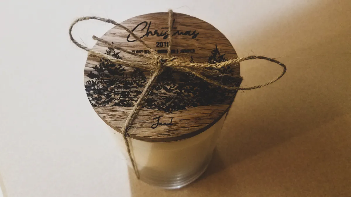

After your lid(s) are cut, sand the top and bottom with some fine grit paper. Do no sand the face of the lid that sits inside the jar though. If you sand this portion the lid might not fit as tightly.
I made a little graphic for each lid on the laser, sanded, and finished with mineral oil and beeswax.
