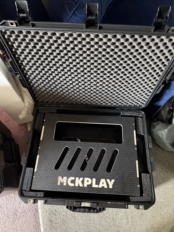

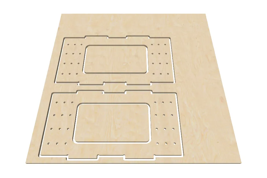

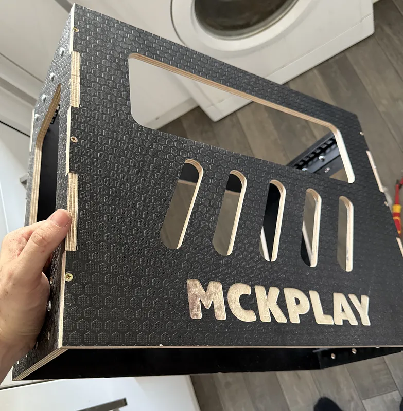

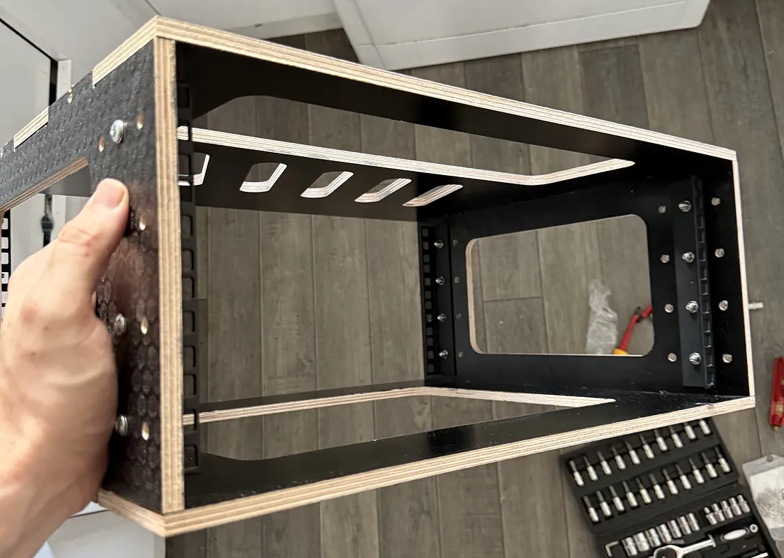

Guide holes drilled by hands then screwed together on each notch. 4 each side and 6 each top / bottom.
This sleeve fits in a Peli Storm IM2750 or a Peli Air 1637 once appropriately foamed.
I made it using a Fox Alien CL-6560 with a 1.5kw Spindle. 1/4 up bit, 18000rpm, 1200mm/min, 3mm plunge depth

Do you have the plans for the Top/Bottom of the rack? Thanks in advance.
Nicklaus BakerPro · September 16, 2025
Hi! Thanks for looking they’re in the easel project as different pages. Hope that helps
