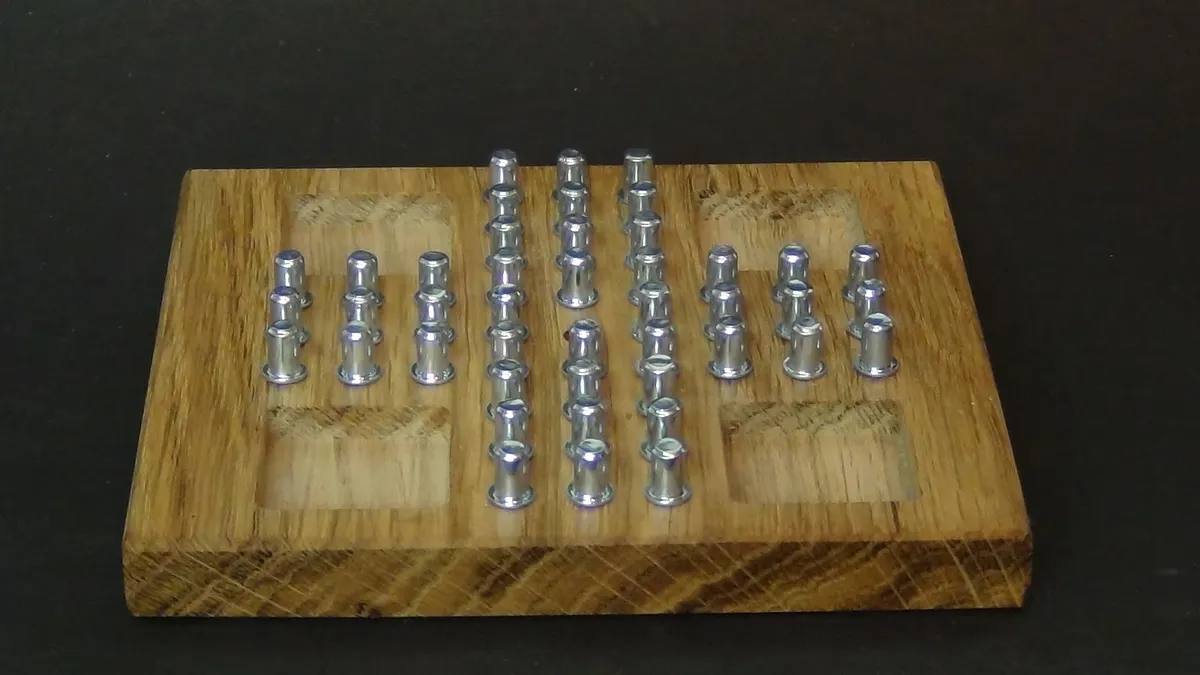

Set your piece of oak square on the waste board, and clamp each edge (don't set clamps more than 1/8" in from the edges) Zero the cutter 3/16" in from bottom and left hand side
Estimated time: 3 minutes
Carve the Playing Board
Attach dust extraction if fitted Load easel file ( http://easel.inventables.com/projects/G47sa1ShkwuEEFJYdfXqmA ) Run the carve (setting the Z-zero position to the surface of the oak) Have a coffee
Estimated time: 30 minutes
Finish Off Board
Saw off the carved playing board (the final shape is your choice) Plane of sand the surfaces smooth Apply a coat of your preferred finish (an acrylic lacquer is my choice for this project)
Estimated time: 15 minutes
Pegs
While the finish dries: Search online, or visit a kitchen showroom, and order enough chromed shelf pins (5mm) to fill all the game holes (a few spares are a good idea too!)
Estimated time: 10 minutes
Complete
Install all the pegs in the holes, leaving the central hole empty Now play! >>>Spoiler Alert<<< You can find a solution to the puzzle "here":https://youtu.be/hEFtApUjsew
