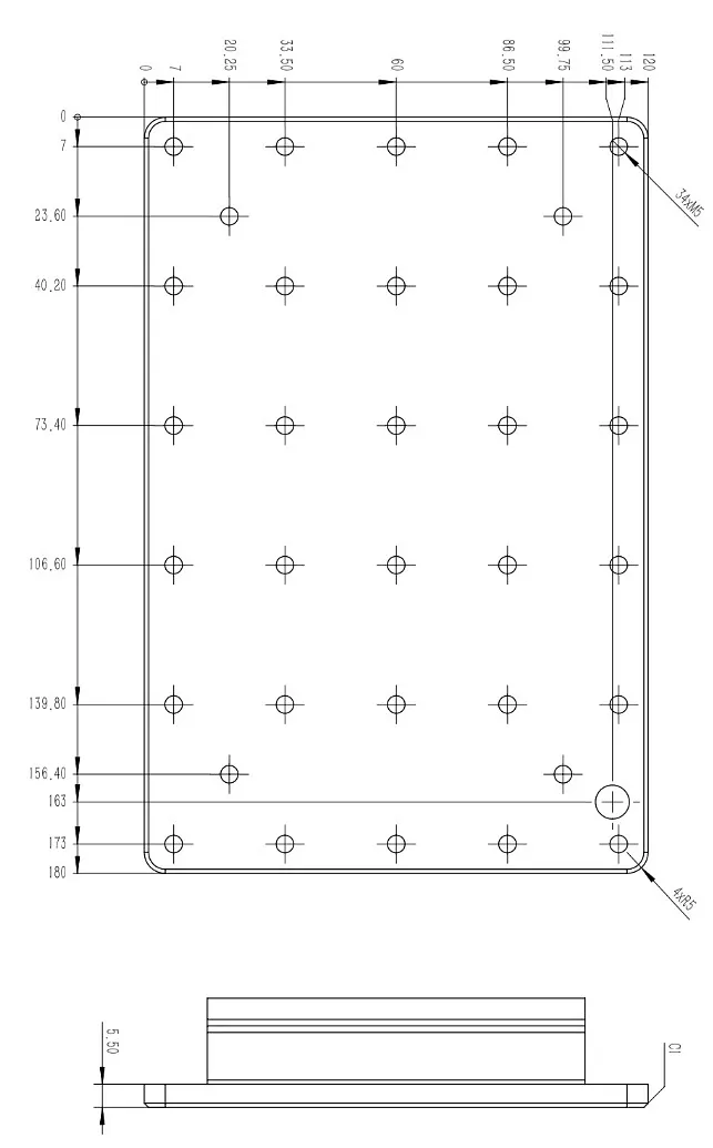

An Easel project for a spoil board designed to fit the Cubiko cnc router or similar products.
other
MDF Wood
Pls check all dimensions as this arrangement works for my machine setup so check your settings

What are the drill and bit size?

As for the Cubiko, they are also in the supporting documents and the drawings are 1 to 1 scale.
