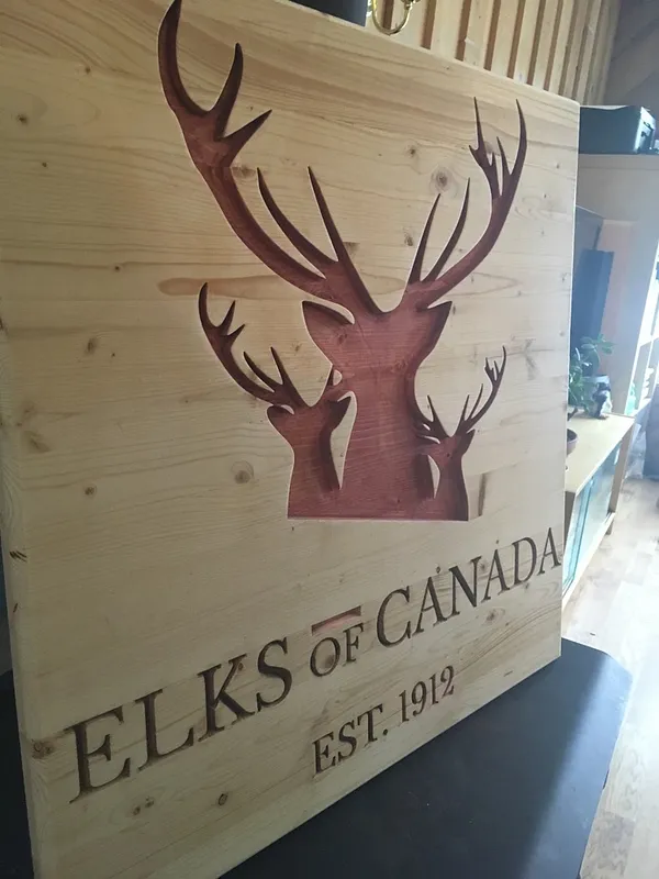

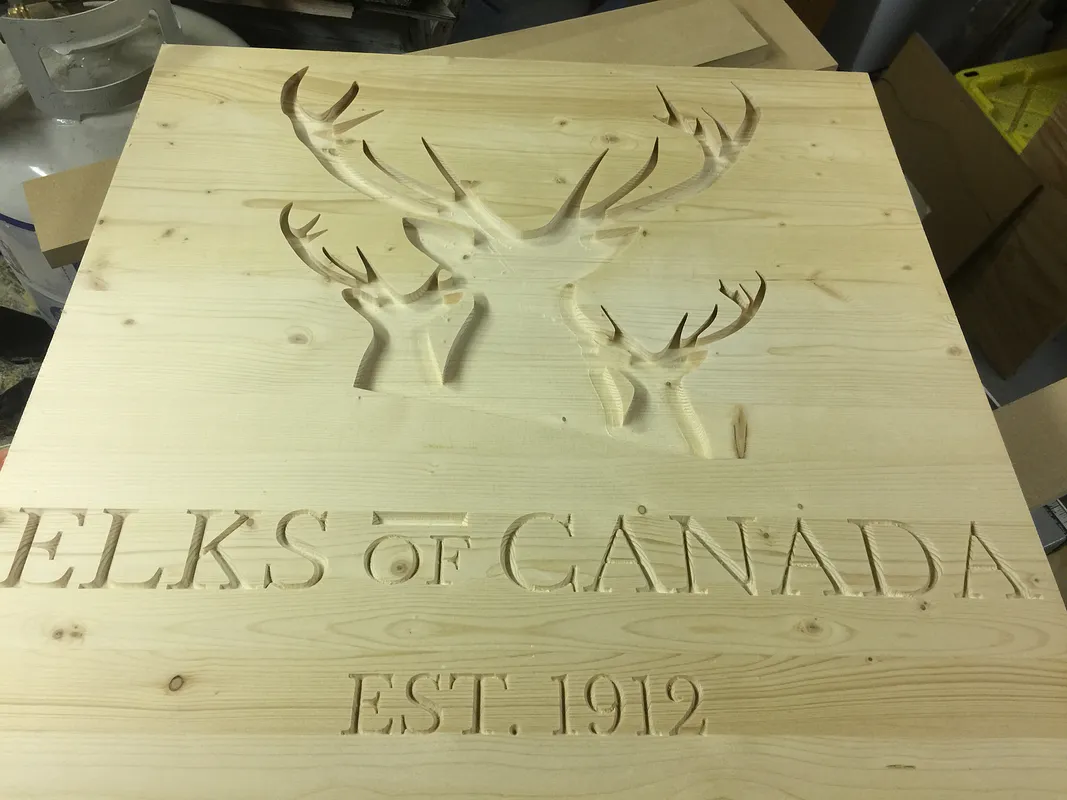

I used 24"x24"x3/4" Laminated Pine. Did a rough pass with 1/8" straight flute bit, for the Elk heads, Followed by a Detail pass with a 1/16" downcut.

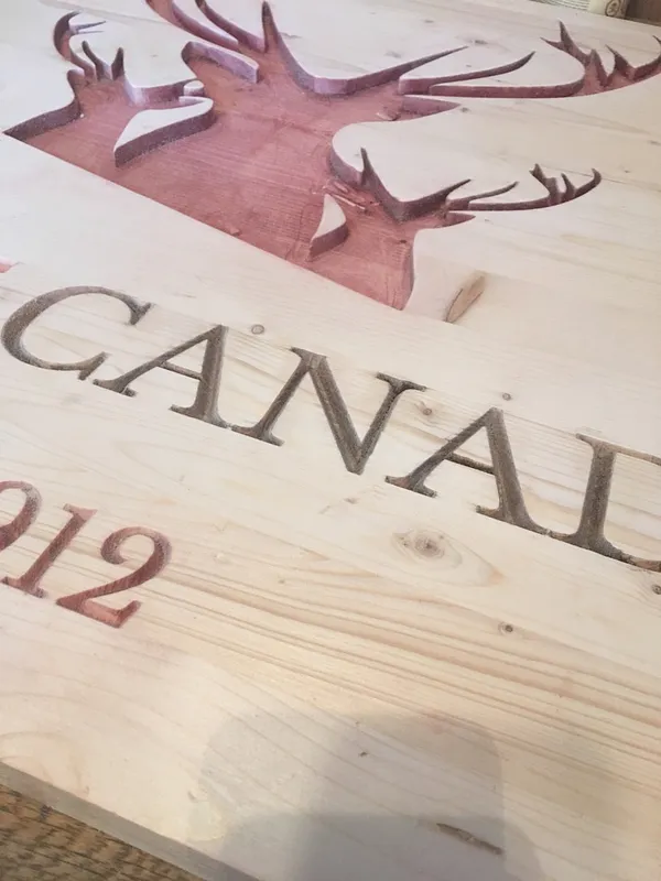

All the Lettering was done with a 60 degree v-carve bit.

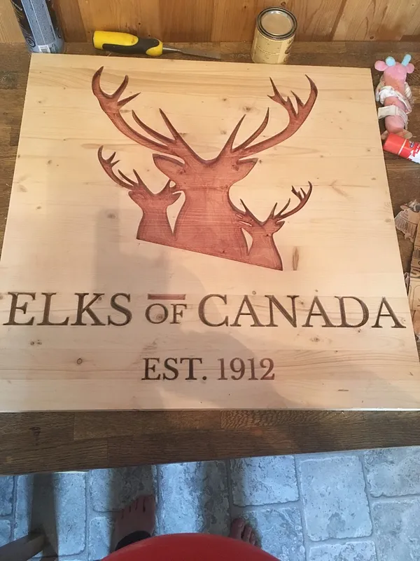

My partner in crime did all the staining. I think it was a Mahogany stain for the elks, and walnut for the lettering, though I could be wrong on the Mahogany.

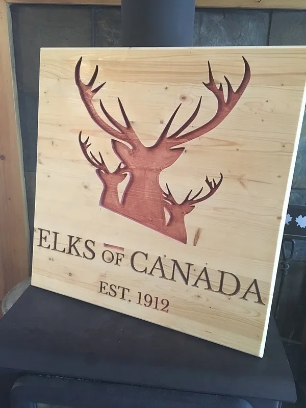

Then 1/4 rounded the edges, sanded it all down, and clear coated it with a Gloss Varathane finish.
