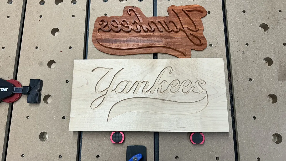

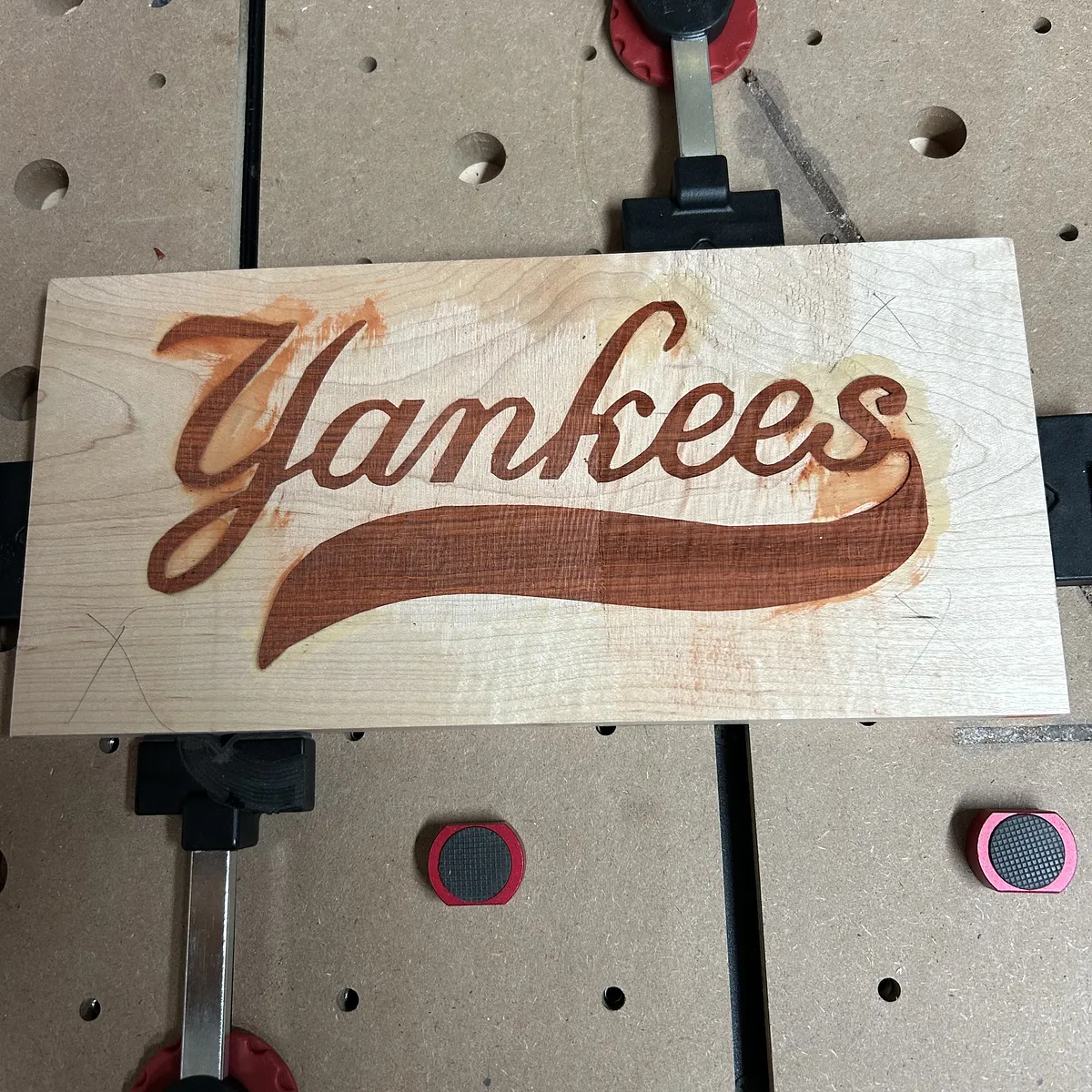

Here's the finished cut! this turned out pretty good The combination of Maple & Padauk looks great.I have a few pictures. The Pocket and Plug side byside and after glueing overnight I cut it off with my Bandsaw ready for surfacing

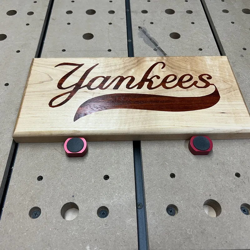

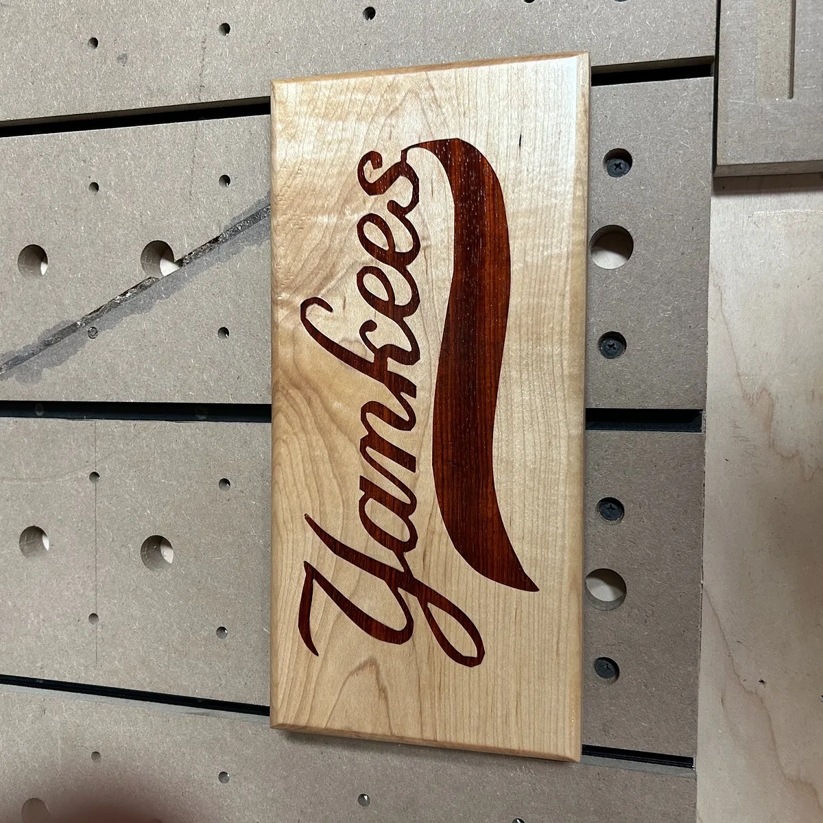

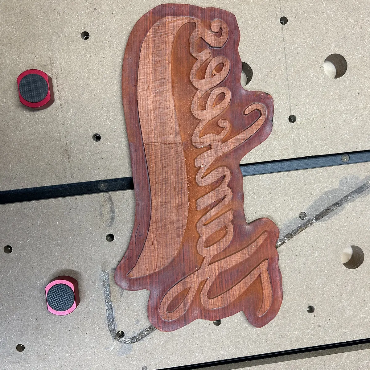

I have a couple of more photos, the leftover plug after cutting it off and the other is the finished sign
Sam DauriaPro · August 13, 2026

@Sam Dauria did you put something on it after you glued and sanded it?
Zach KaplanPro · August 20, 2026
In the finished picture you see the only thing I did to it was 2 coats of Walrus oil. I just put a clear spray on it today
Sam DauriaPro · August 20, 2026 · edited
The oil and spray really make a big difference. Looks great!
