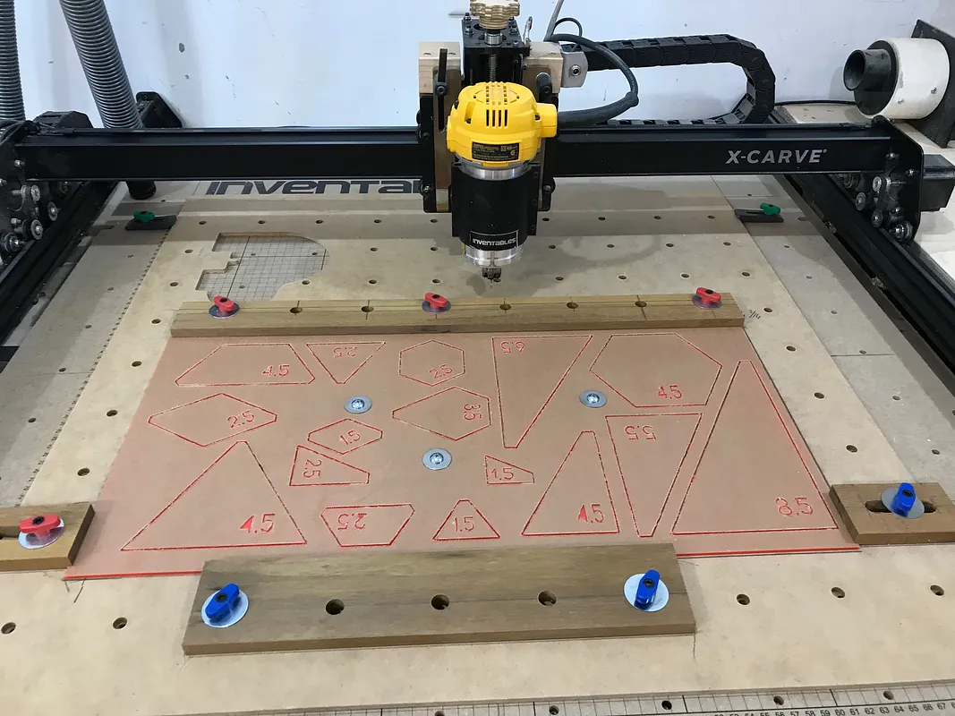

My Mother-In-Law is a quilter and asked me to make some custom rulers for her to make letters with. She got the design from a catalog. I digitized the images into SketchUp and then transferred them to Easel.

Can you upload your waste board with holes and your clamps? Super interested in these!
Brodey Sheppard · November 15, 2017
The waste board is 1/8" hard board that I drilled through holes over the x-carve board to line up with the threads. The clamps are old hardwood flooring that I planed down and ran through the table saw to put half a saw kerf one the edge to hold down the 1/8 in acrylic.
