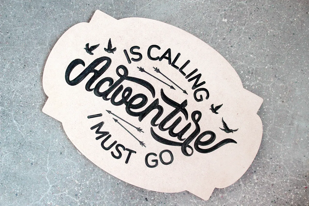

I used a V-bit for this project to get all the little details of the artwork.
First, engrave the lettering, and then click over to the next workpiece and carve out the outline.
Estimated time: 15 minutes

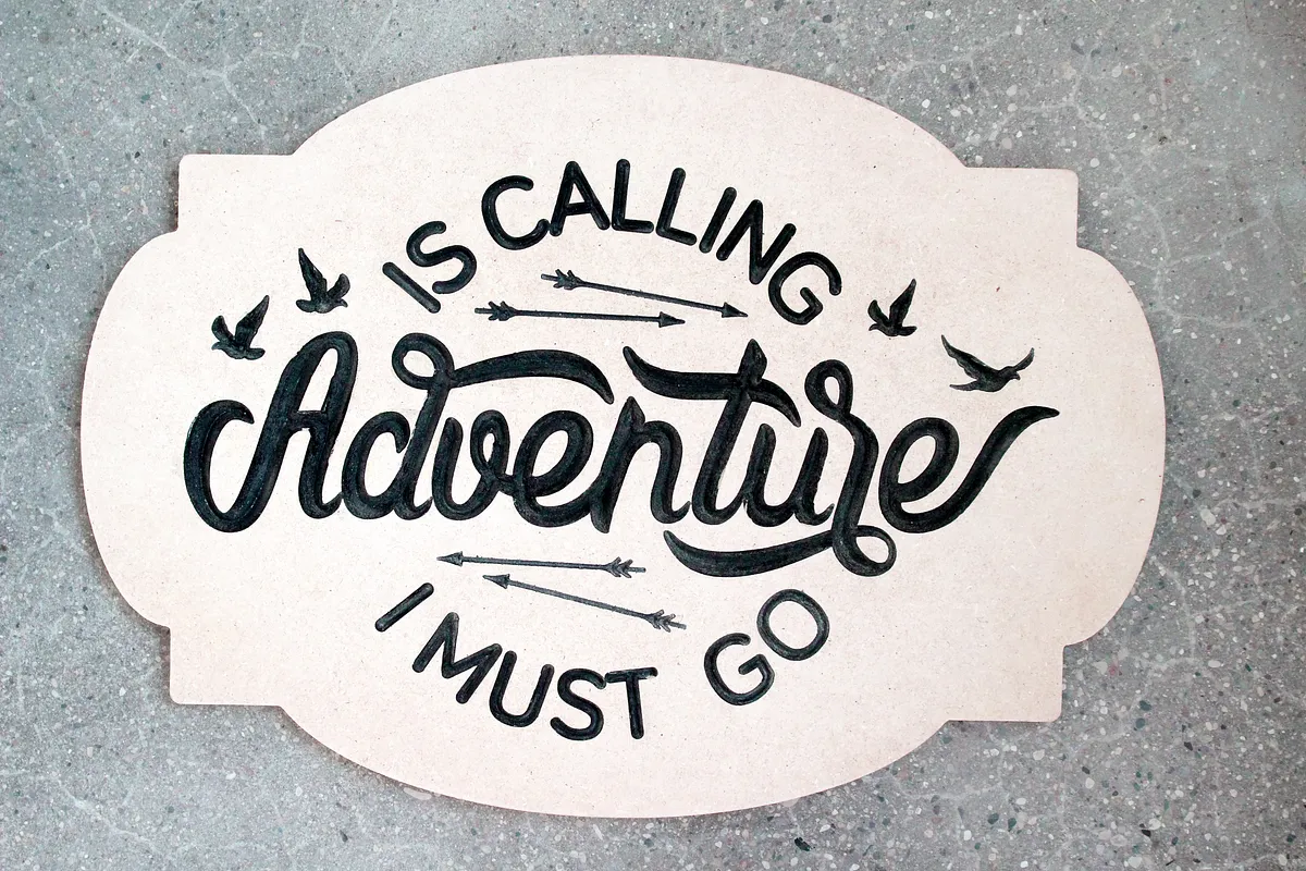

Paint the letters
Once the sealer is dry, use acrylic based paint and fill in the letters. It is ok to be sloppy! You can get the paint on the surface because we will sand it off later, the sanding sealer will prevent the paint from seeping into the material.
Estimated time: 5 minutes

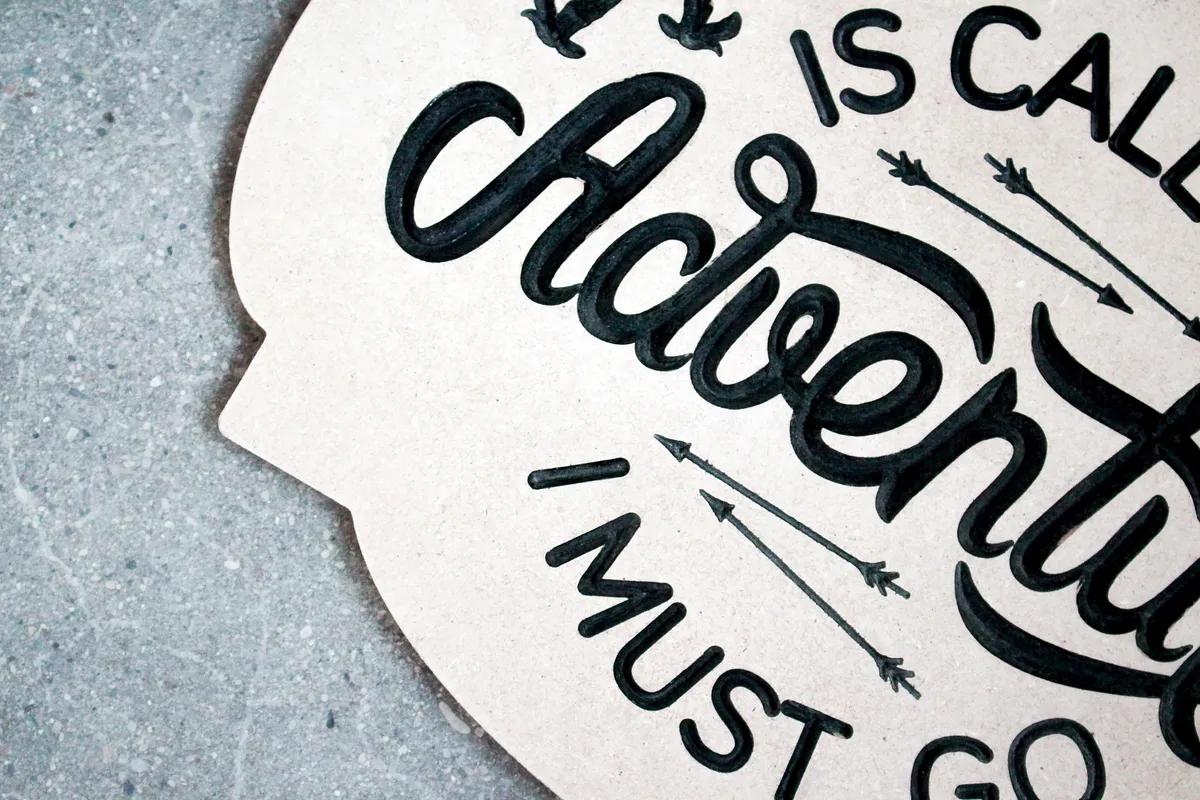

Sand
Use a palm sander to sand the surface of the sign. This will both remove any paint that is on the surface of the sign and give the MDF a smooth finish.
