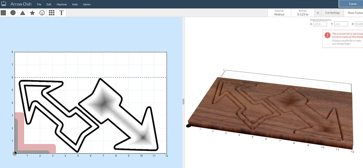

Cut arrow parts
Click the "Open in Easel" button to open the digital file on your computer. My piece of wood was about 1/2" thick, and I used a 1/8" bit. Be sure to either use tabs or double-sided tape to secure the material.

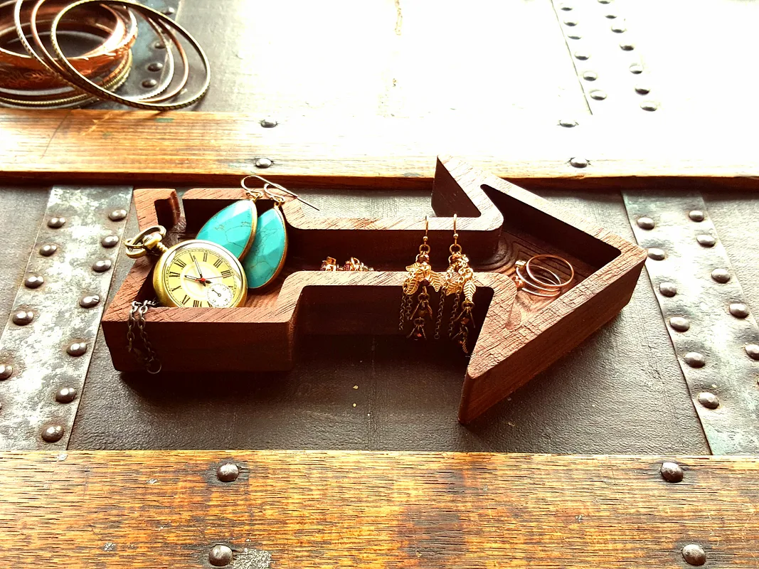

Assemble
Stack the two pieces on top of each other and glue together. Once dry, sand down the seam and any rough edges. I finished my dish with mineral oil to give the wood a little shine.

I really like this design! Great work! Is there a way to automate the gradient or did you set the depth for each step? Thanks so much!
Michael Campagna · July 07, 2016
Thanks! I set the depth for each step manually. As far as I know there is no way to automate this yet, however it would be a great addition to the Easel App Library if a developer wants to take the lead on that one!
JulesPro · July 07, 2016

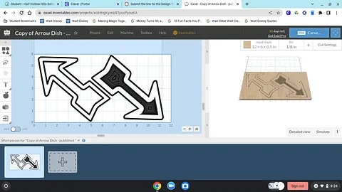

Hi Jules. Is it possible to contact you about designing a similar dish but with a different design?
Ashley Gaulden · January 15, 2023
Hi Ashley, Easel makes it super easy to create projects like this arrow dish yourself. Feel free to use this concept to inspire your own designs! You can even open this project in Easel and edit it directly.
