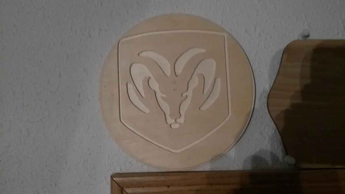

Setup and Carve

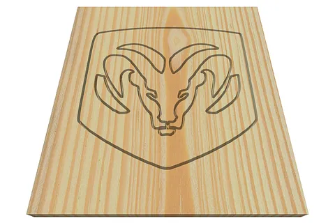

open in easel and make sure all your settings are correct
Easel setup:
When you open this in easel please make sure and check all your settings as mine may not work for you
Saftey Height: .150" Step over: 40% Feedrate: 60 in/min Depth of cut per pass: .0625" Depth of total cut: .050" material thickness: .25" Material type: Birch Plywood Bit Size: .125" Bit Type: solid carbide 2 Flute straight flat end mill
I hope you enjoy this simple project if you have any questions just let me know
