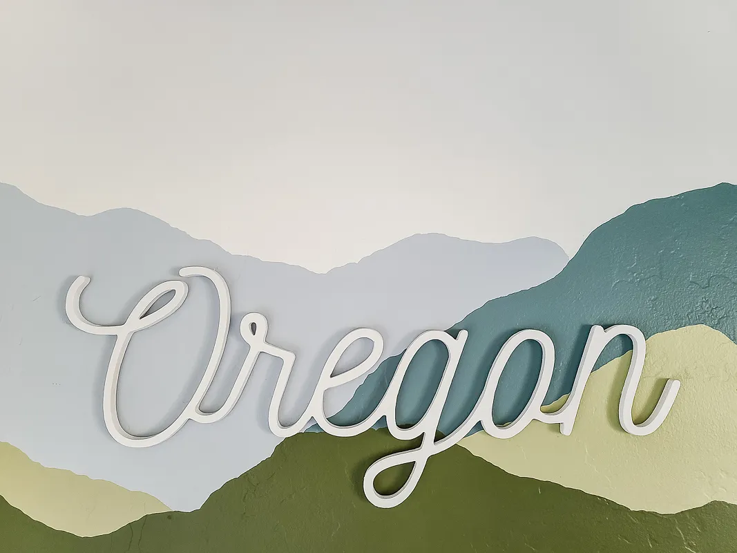

We used our Dremel rotary tool to slice through the tabs that the X-Carve leaves behind and then cleaned up further with the Dremel and a 150 grit sanding bit.
Be careful, however, because some of the spots on the letters are thin and very fragile.
Estimated time: 20 minutes
Prime and paint
Next apply several light coats of spray primer and white spray paint. Let dry.

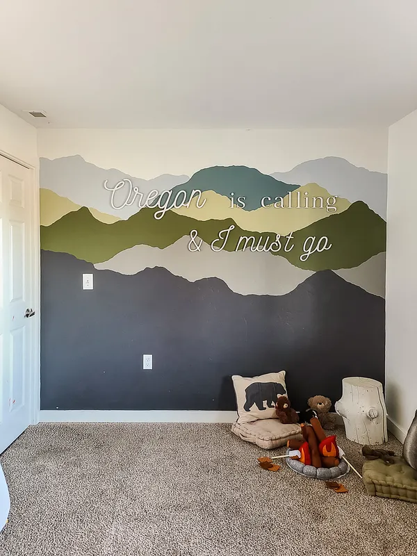

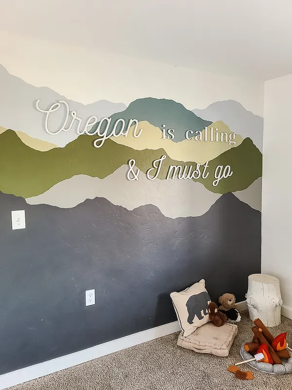

Hang quote on wall
Cut down Command picture hanging strips into smaller pieces and put on the backs of the letters. Have one person hold a level on the wall and another person press the letters into place. Hold for 30 seconds to secure.
