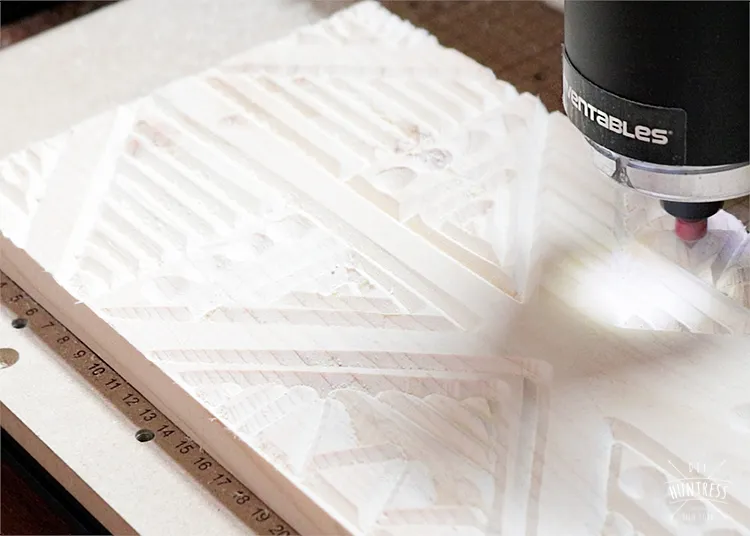

For this project I used a 1x8 Pine board. While the final dimensions of my board were 1x8x16", I made sure to leave 2" of room on both sides of the board (i.e., board cut to 20" wide) for the clamps.
I also used a 90 degree V-bit.
You can use whatever size works for your drawer front!
Clamp & Carve
When ready, just clamp and carve your drawer piece. Trim your drawer front to size when done with your carve!
