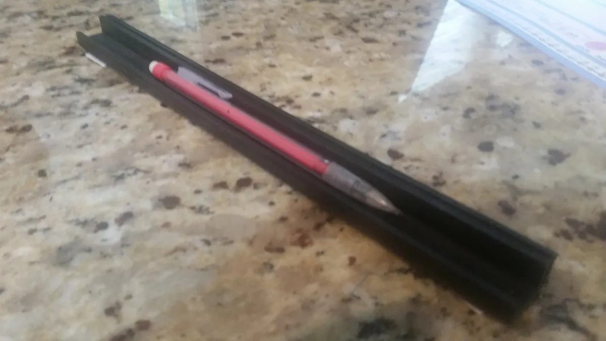

Carve the Easel project
The project takes about 9 hours to carve using a 1/16" fishtail tool. This could be shortened if you're willing to do a tool change and only use the 1/16 (or smaller) tool for the nametag slot.
Estimated time: 540 minutes

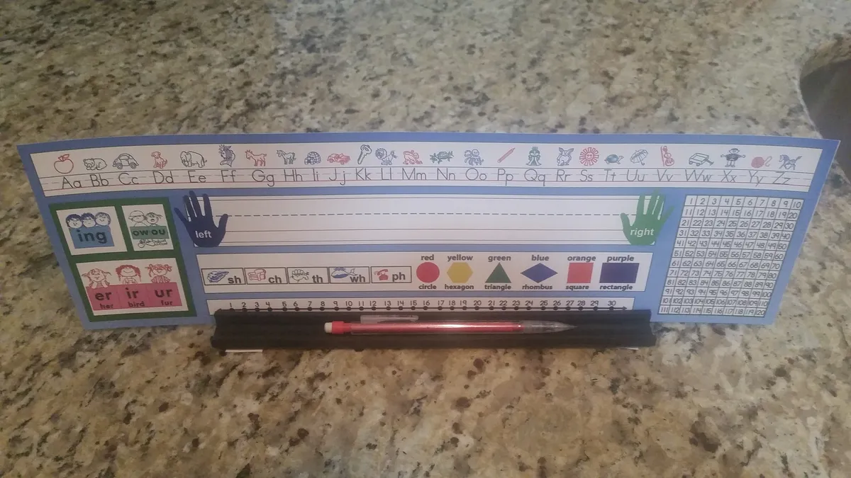

Insert nametag and velcro to the desk
Using adhesive velcro dots we attatched the nametag holders to the students' desk. Done!
Optionally you could laminate the nametag. It makes them hold up longer, especially if you'll be moving the nametags between holders in your classroom.
Estimated time: 15 minutes
