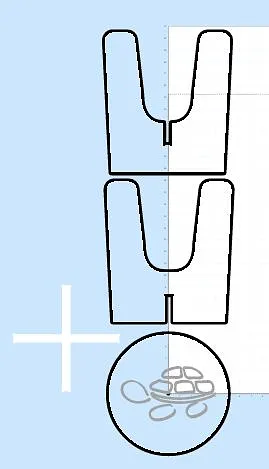

I imported a hand drawn image into Inkscape and then turned that into a usable .svg for Easel.
Estimated time: 20 minutes

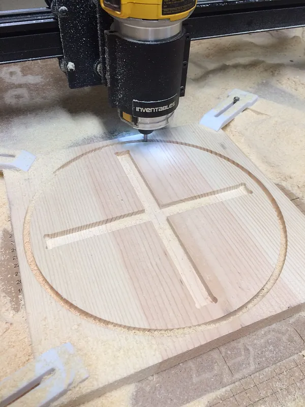

Cut Stool Top
Cut the stool top out first. I started with my design using a 1/8" bit and then flipped it over and used a 1/4" for the rest of the cuts. I marked the center of each side and used the origin in Easel for the home position.

Cut out Legs
Cut the legs out two at a time. I had to go back and modify the center cuts slightly so they were oversized enough for a snug but easy fit.

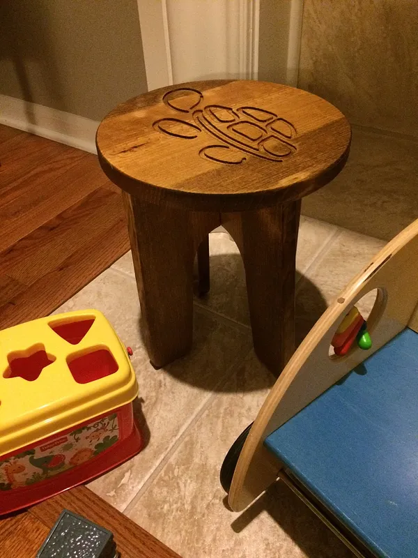

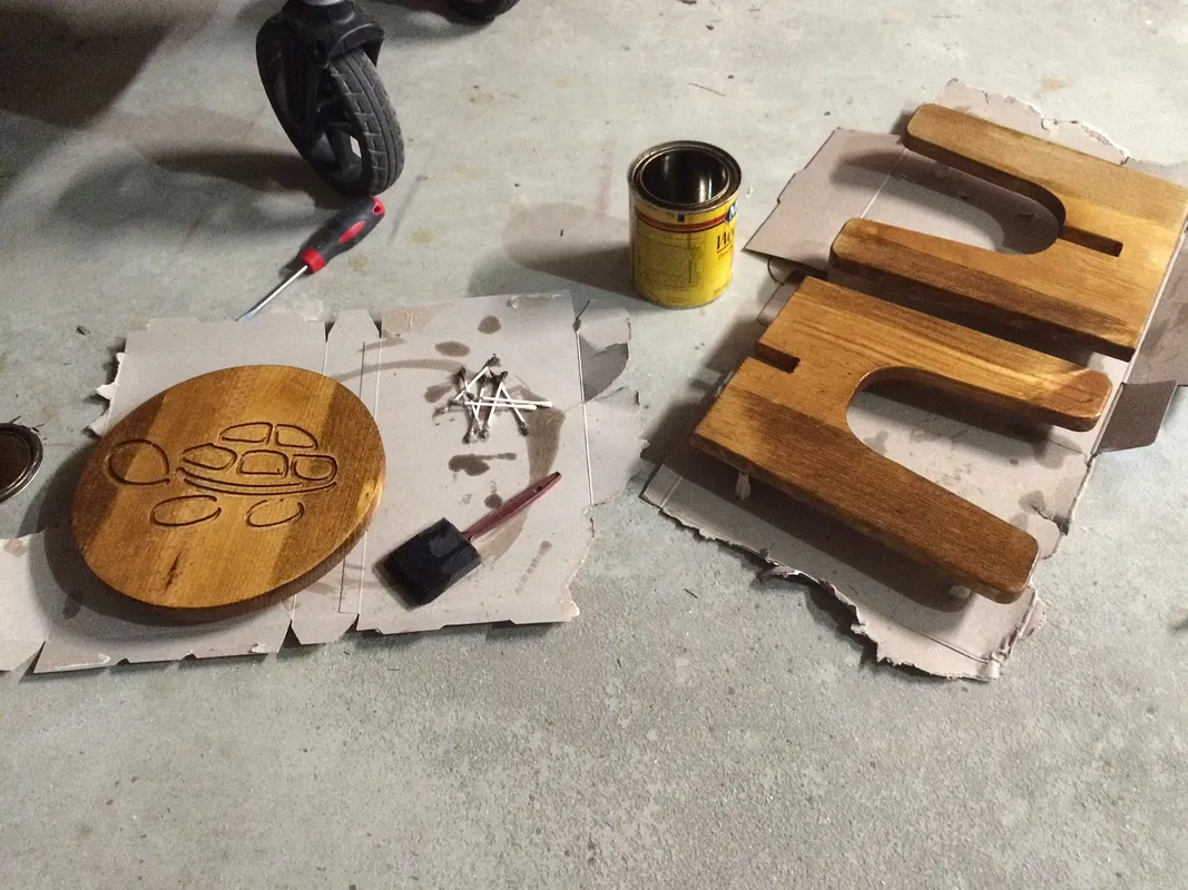

Finish & Assemble
I used a router table to round all edges. Then used several coats of a lighter stain. Assemble, glue up and enjoy!
