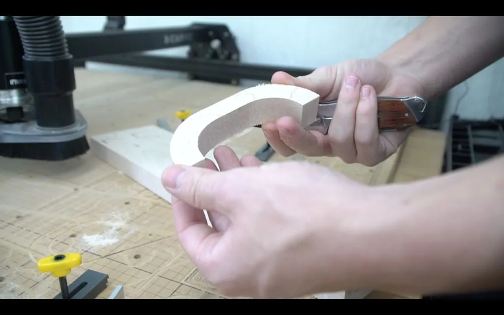

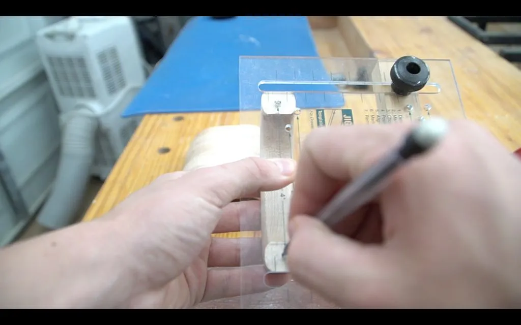

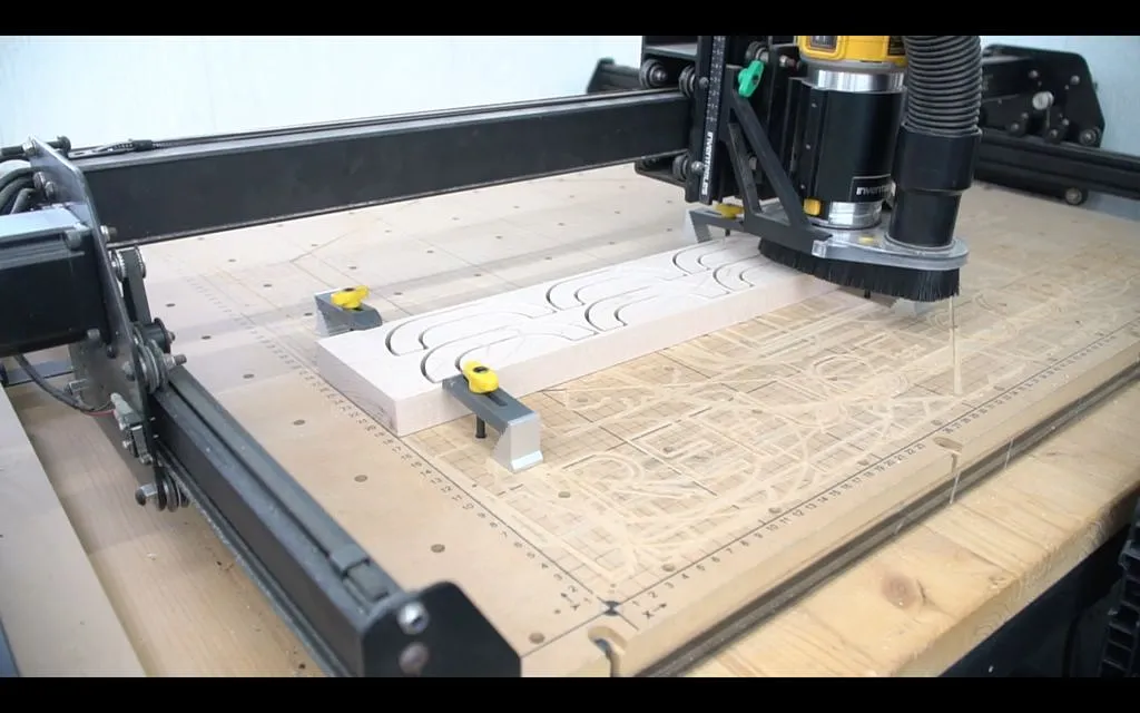

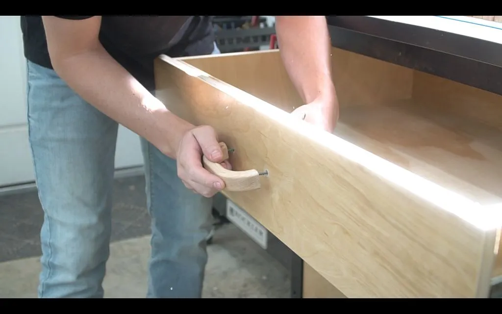

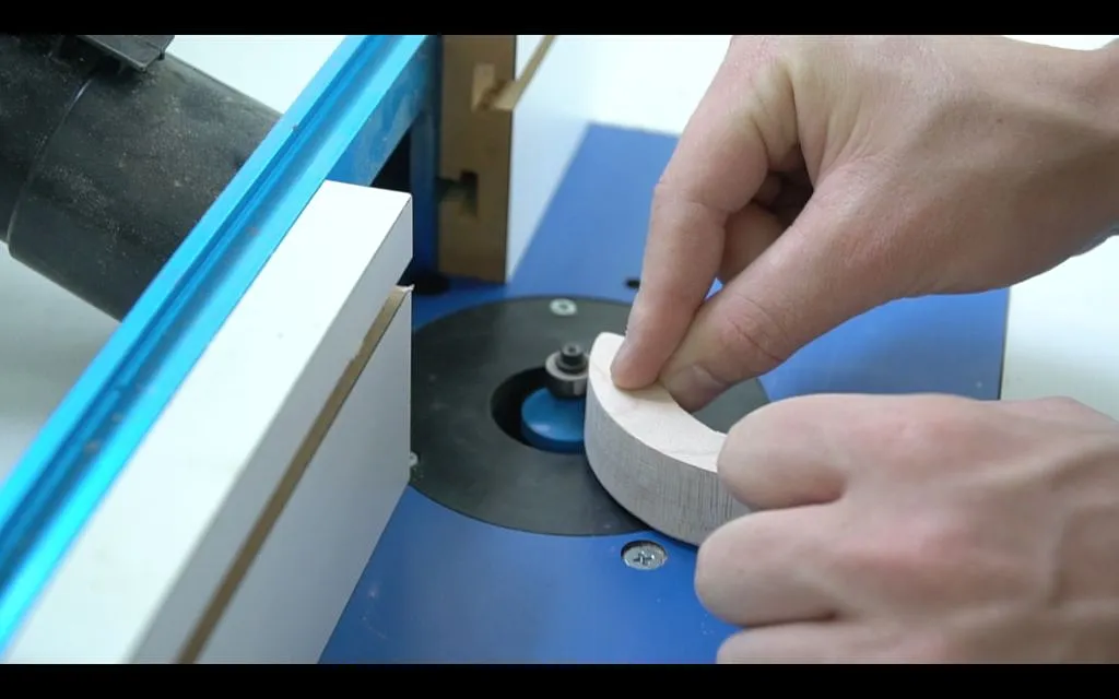

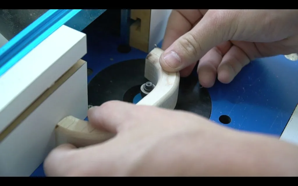

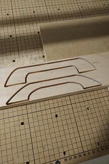

First use the attached Easel file to carve the outside shape of the drawer pull. Next round over the edges using the router table or sand paper. After a bit of hand sanding we applied a wax finish to the handles. We used this Rockler jig to mark the hole locations (4" apart) on the handles and pre drilled the holes. Lastly we attached all the handles to the drawers using wood screws.
