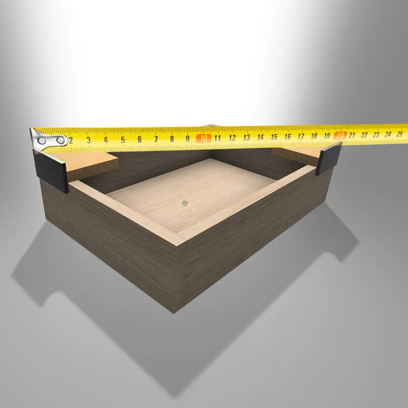

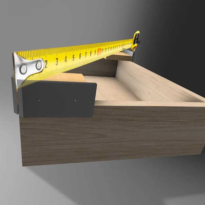

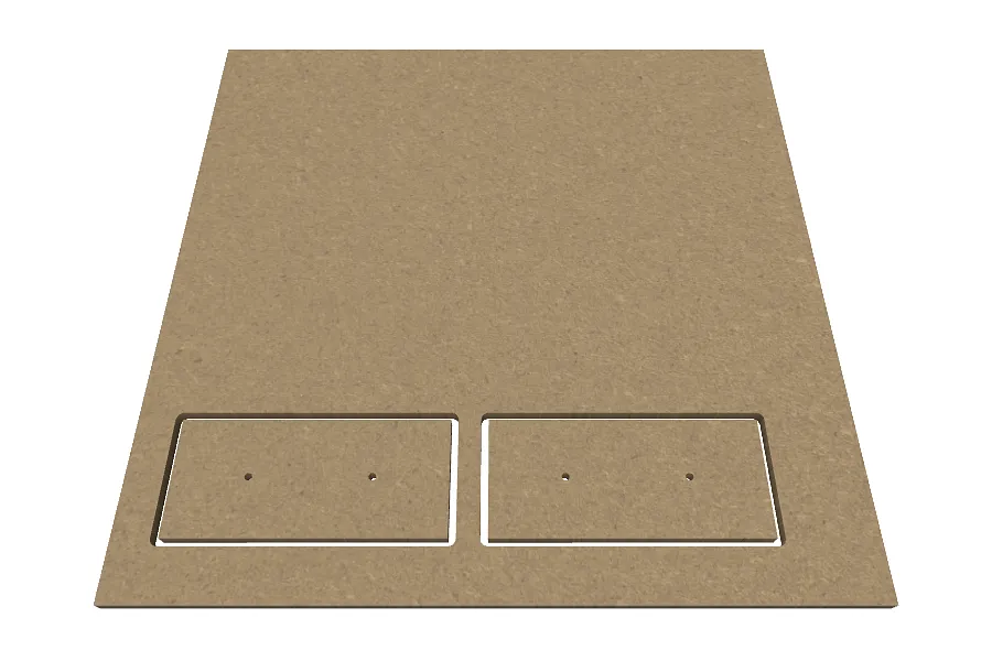

Quick little jig for making sure case work and drawer bottoms are square. These little jigs sit on opposing corners and provide slots for the tape measure, which helps you get far more accurate readings. Quick and easy to make and from scrap too!
X-Carve Pro
Birch Plywood, MDF
