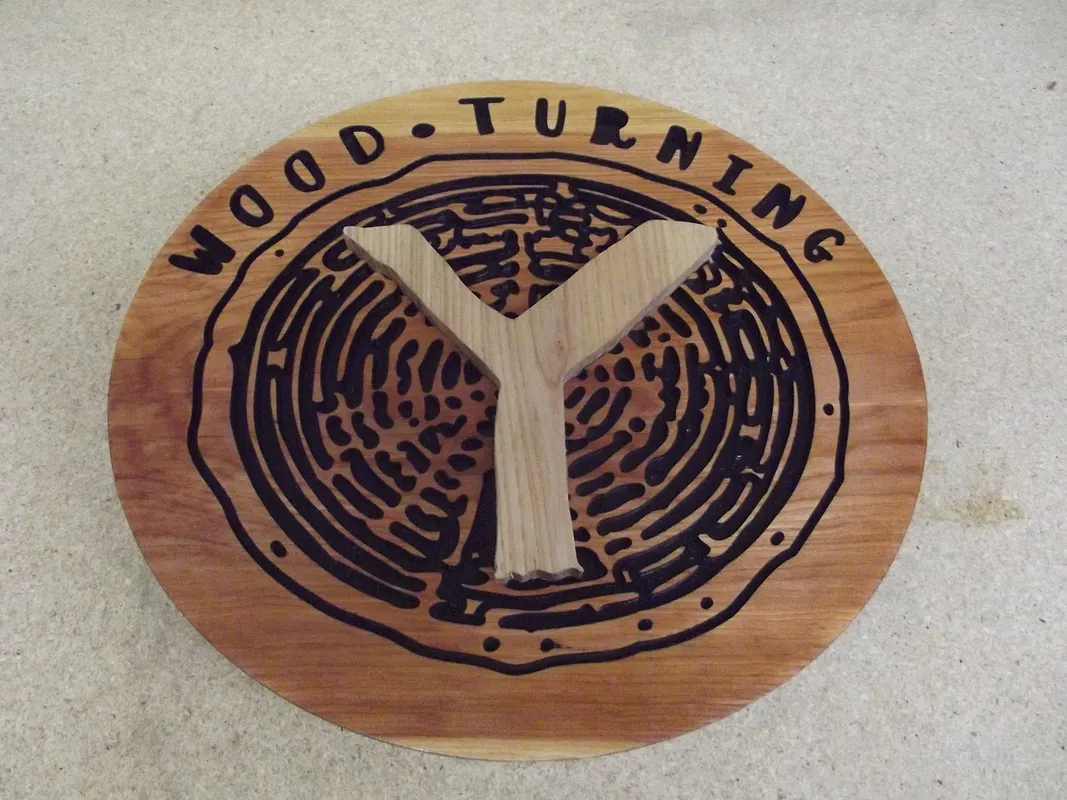

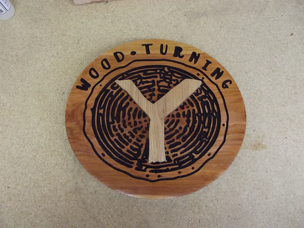

Black Paint and Sanding
Paint the sign Black. Make sure to spray from all sides to get a good coat on the insides of the carved out part. Let it Dry Remove the paint on the surface with the sander. This should leave the black only in the carved out parts of the sign. Sand to what ever grit you like. On this project I sanded to 220. Also take this time to sand your inlay to the same grit.
Estimated time: 45 minutes

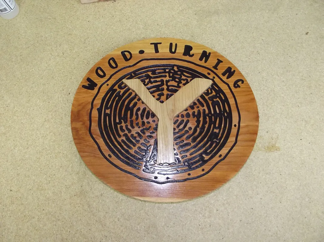

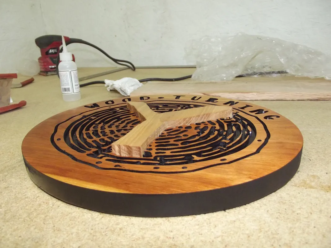

Put it together!
Now that is it all sanded. Take the super glue and glue in the inlay. It should be a tight fit. Clean all the dust from the sign and Spray the clear coat on all of it.
