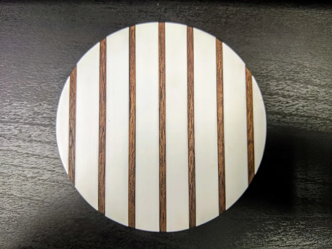

This is a pretty straightforward project. You can find more information over on my tumblr about this project: https://fredhousel.tumblr.com/post/187165690515/corian-walnut-coaster

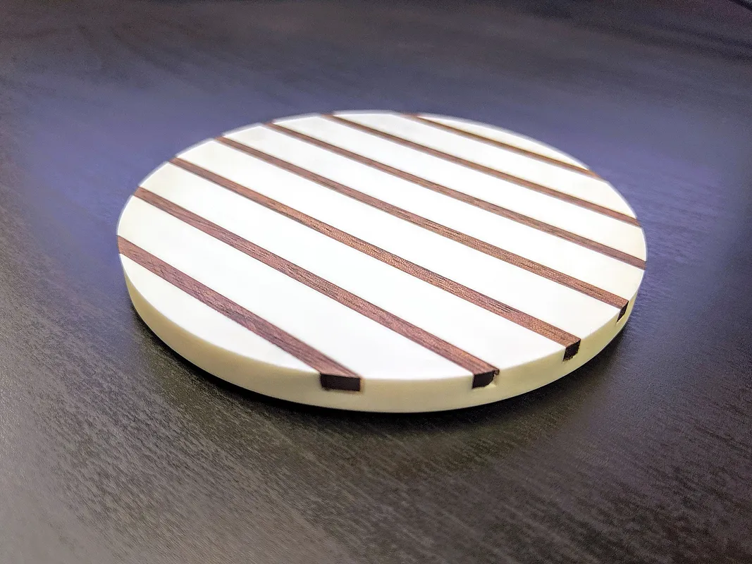

Simply cut the corian pieces, carefully cut the 1/8" walnut into 1/8" square strips, cut the strips to length, then assemble with CA glue.
The total size of the coaster is 3.75" in diameter. Optionally, you can cut a 3.5" diameter circle of 1/6" cork and glue to the bottom for a non-slip surface.
