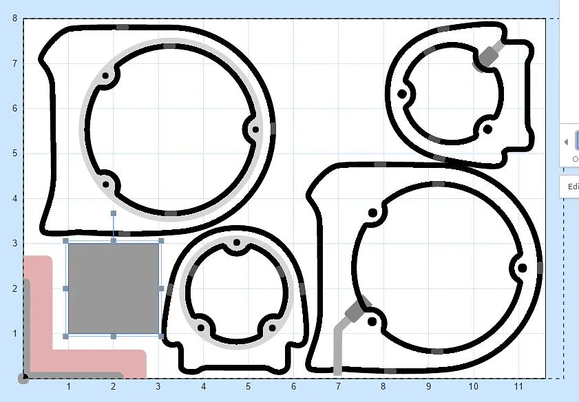

Cut out the Frame
Load this "Easel link":http://easel.inventables.com/projects/VGem3SSHnTVcCeYd6fmJFw to cut out the Frame using an 1/8" bit.

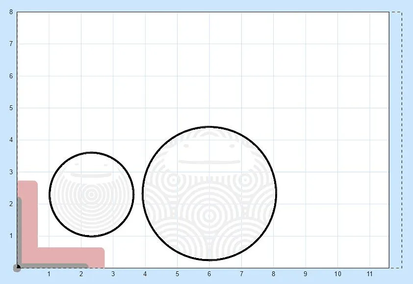

Cut out the Cap
Load this "Easel link":http://easel.inventables.com/projects/ciIU-VVebAuOsZXi8N42EQ to cut out the Cap using a 1/16" bit.

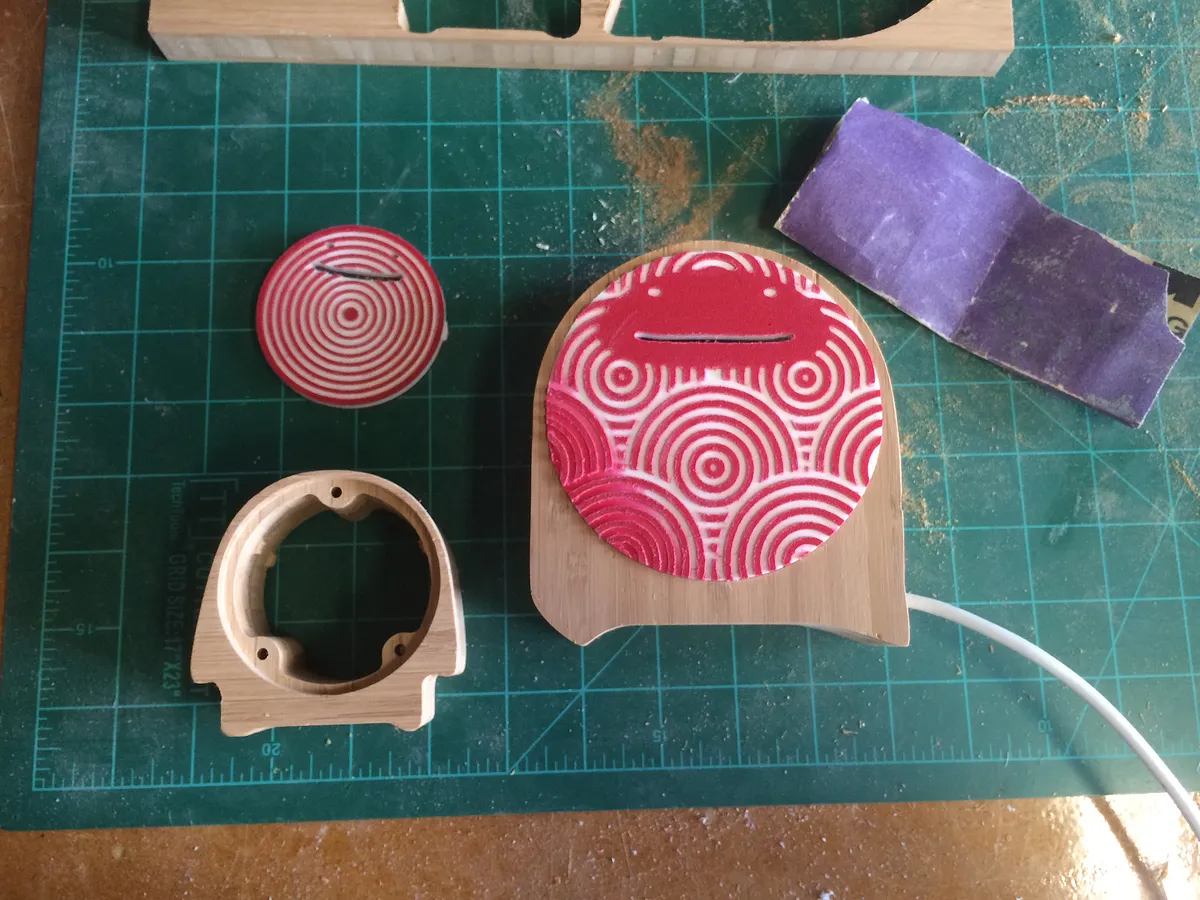

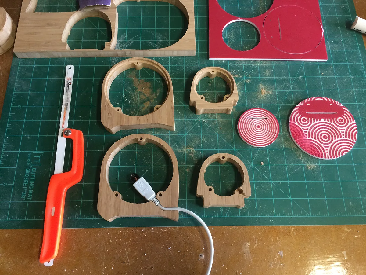

Remove the parts
Separate the parts, and sand them down as needed.

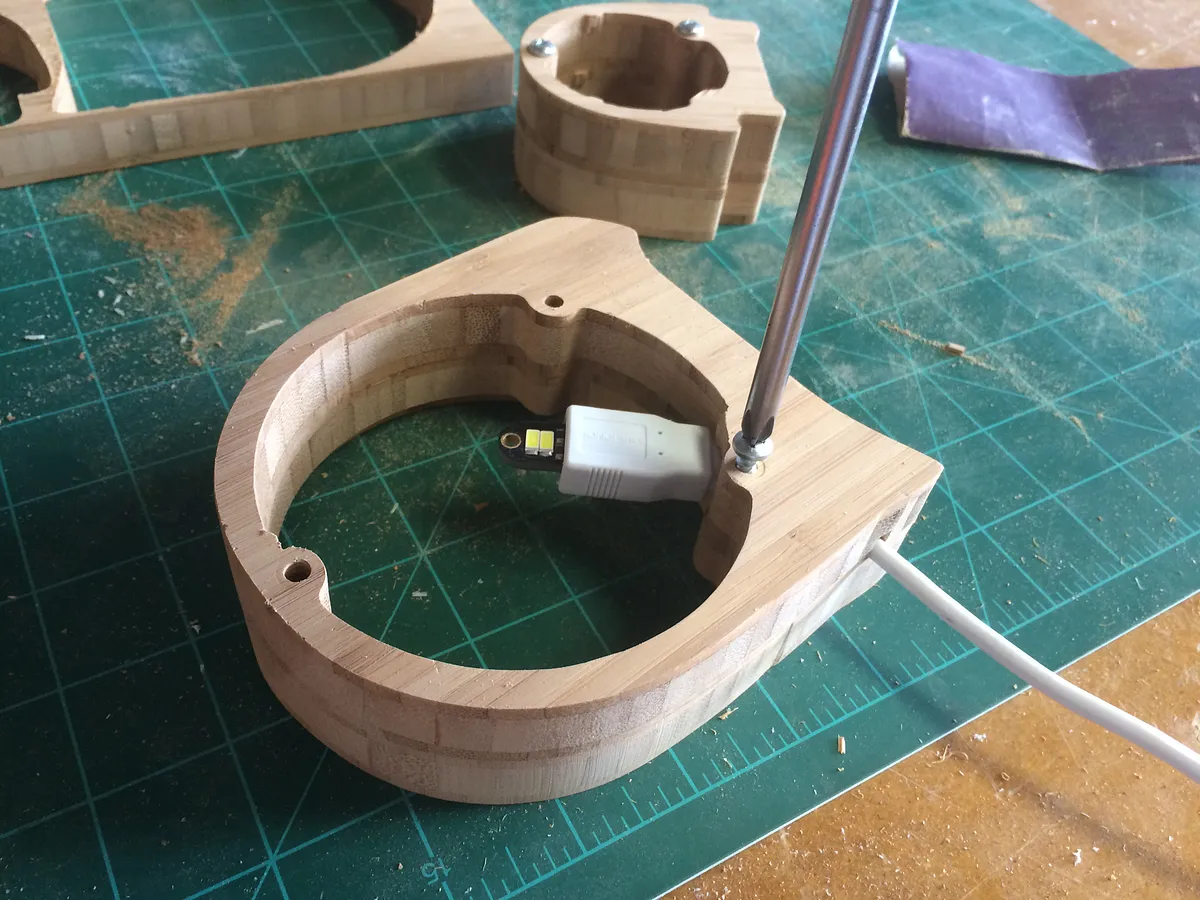

Assemble the Frame
Insert the USB cord in the slot and assemble the frame.

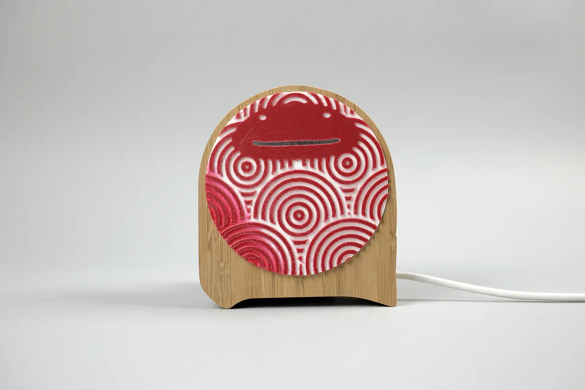

Snap the Cap in
Depending on the tolerance, the Frame should hold the Cap in by friction. If not, you can use adhesive.

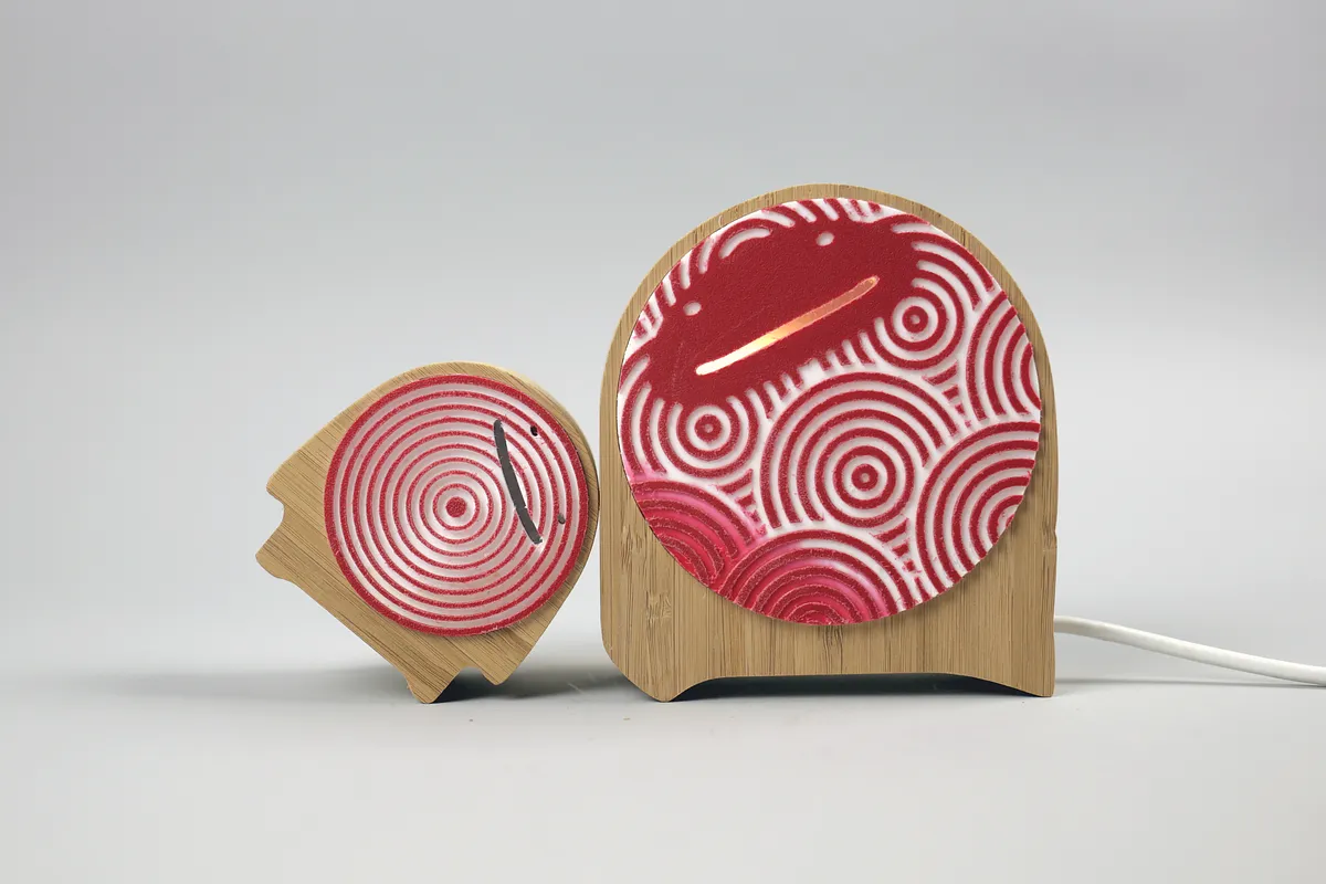

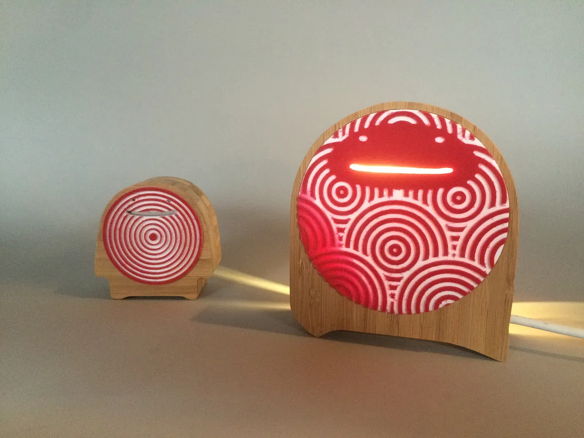

Plug it in

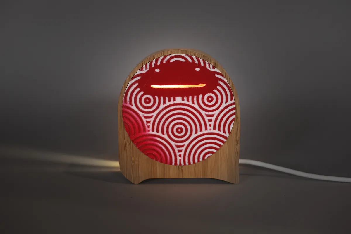

Insert the LED light in the USB port, and plug the other end of the cable in your spare phone charger.
Tip: You can make a paper cut out to cover the hole in the back for a more even diffusing of the light.
