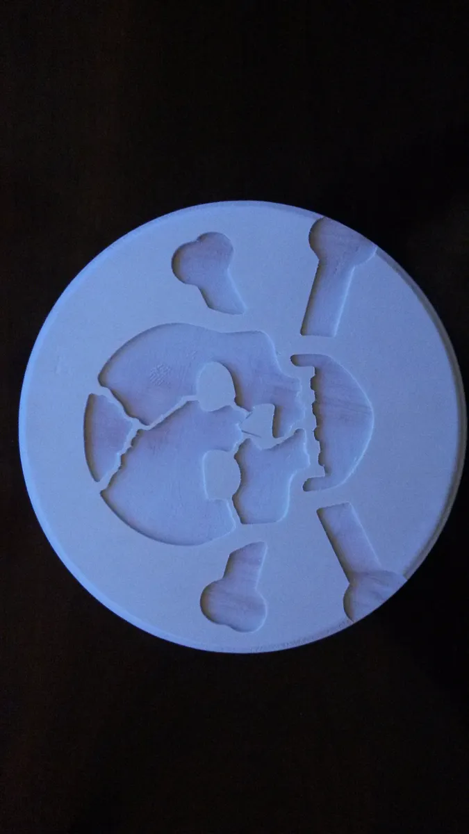

When you open this in easel please make sure and check all your settings as mine may not work for you
Saftey Height: .150" Step over: 50% Feedrate: 45 in/min Depth of cut per pass: .0625 Depth of total cut: .050" material thickness: .25" Material type: Birch Plywood Bit Size: .125" Bit Type: solid carbide 2 Flute straight flat end mill
