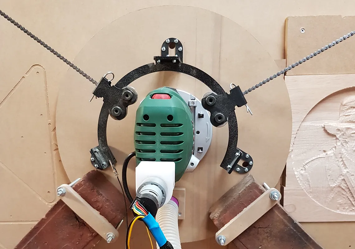

Ring mounts
The ring mounts are positioned with M12 bolts then screwed in place

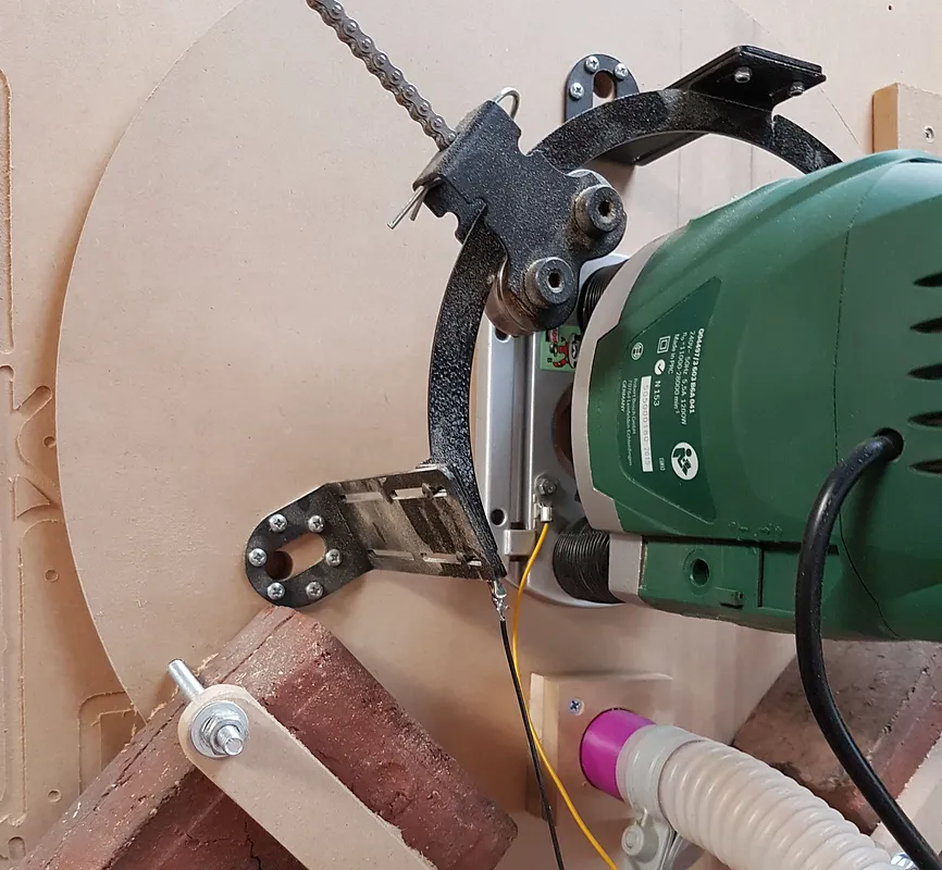

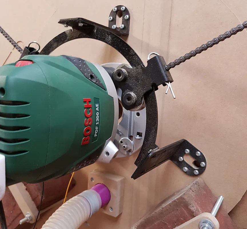

Router attachment
Remove the plastic plate from the base of the router. Using five M4 x 15mm hex head bolts with flat and spring washers, attach the router to the MDF
Vacuum
Attach the vacuum raiser and file/sand to fit your vacuum hose
