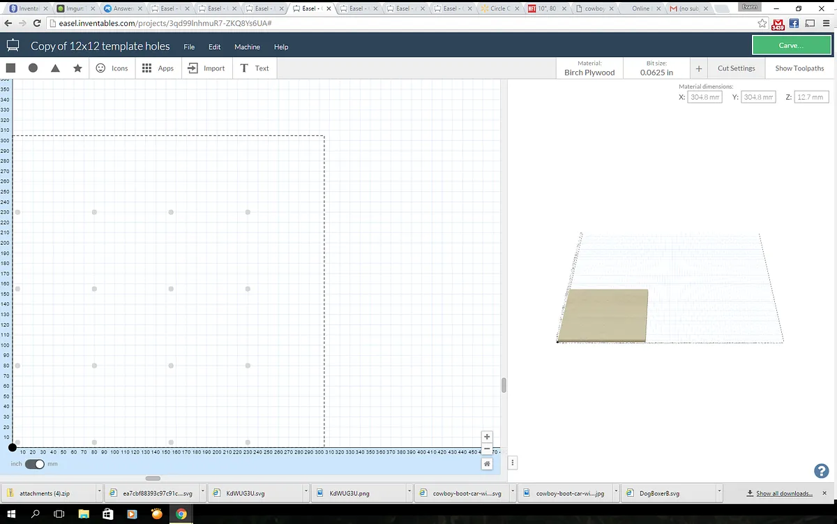

alright so this template will allow you to make perfect holes in your material so you can through bolt it flat to the inventables waste board
just delete holes and place your projects where they need to go with no worries that your machine will crash into the bolt heads
just make sure under the machine tab in easel you set your saftey height to clear the bolt heads by a couple millimeters
