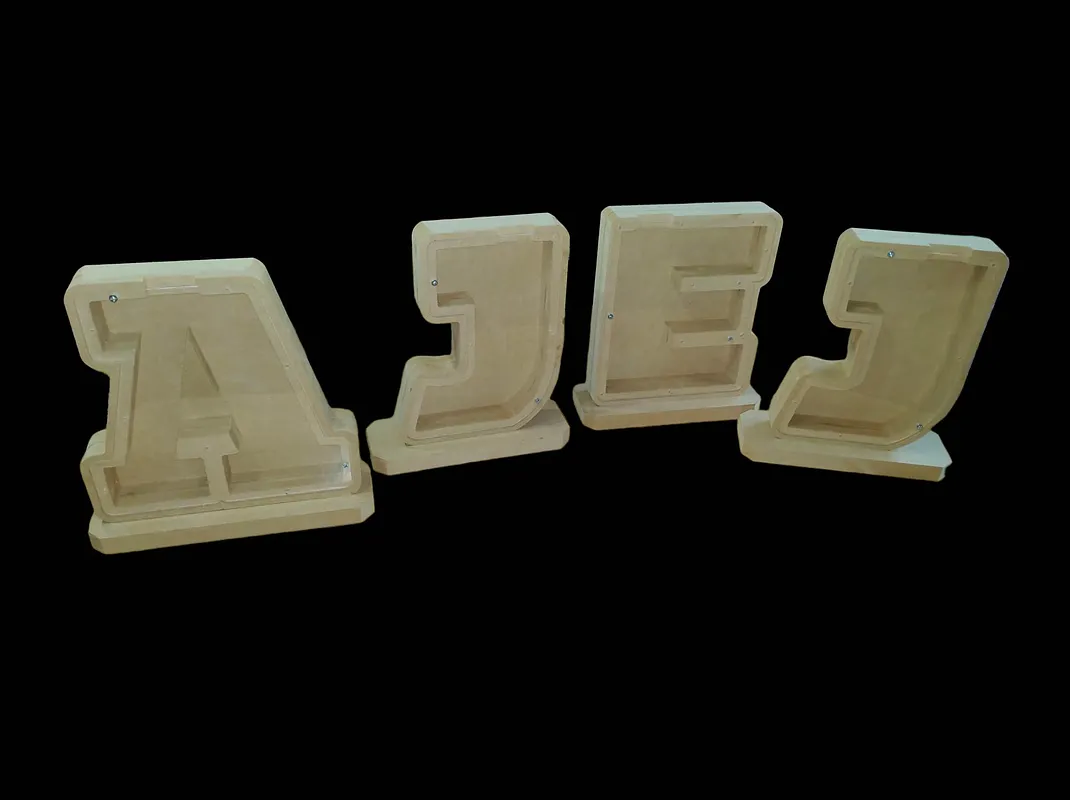

Cutting
All you have to do is cut the 2 pieces and glue them together. I used small #4 (1/2") flat head screws to attach the plexiglass. In the part where the slot is, don't worry about the screw holes, they are there just for reference. With the 1/4" bit you wont be able to drill them. The plexi glass that I used was .1 thick.
