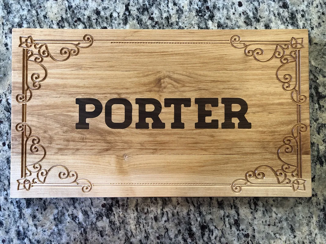

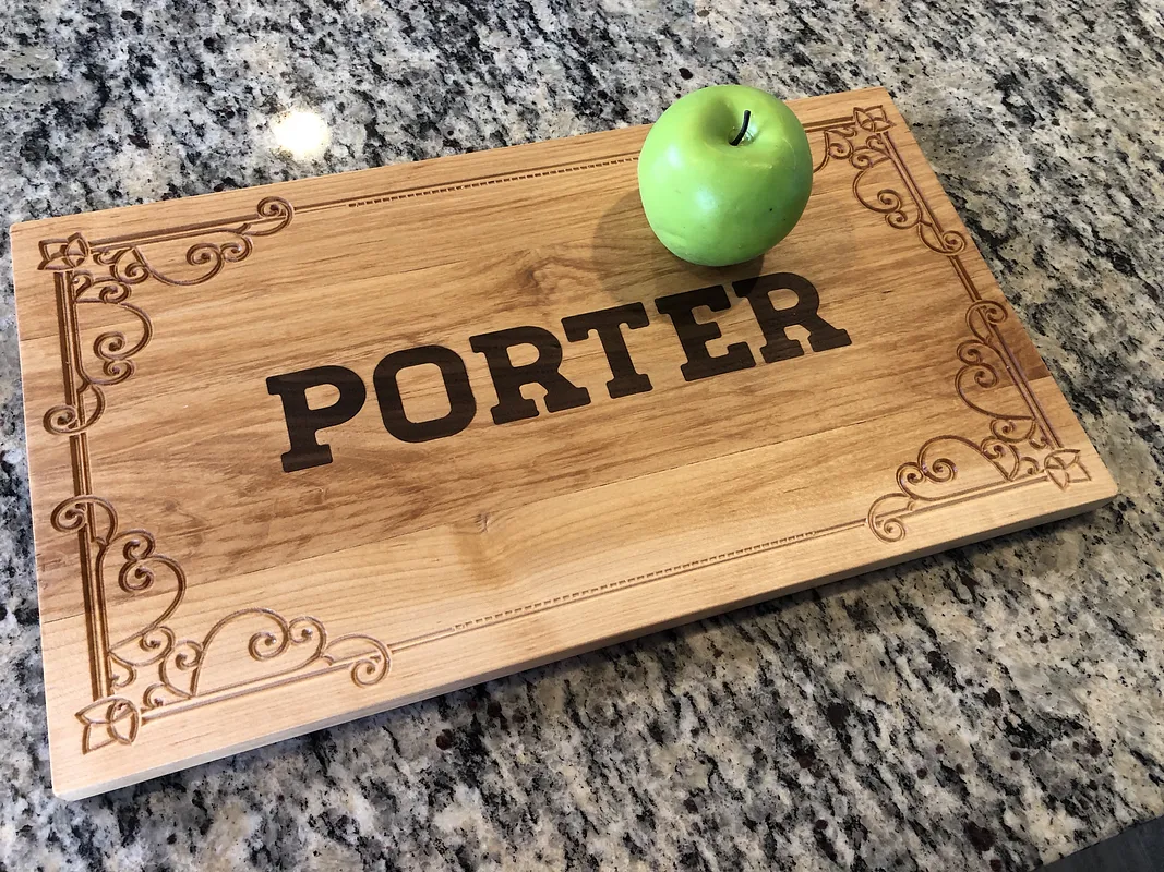

There are multiple workpieces to carve, but it should take less than an hour of total carving time. After it is done you'll want to carefully clip the tabs off the inlay and hand sand the tabs to be flush with the rest of the letter.
The cutting board itself is 10"x18". I glued up four 2.5"x18" strips of hard maple to make this.
Estimated time: 54 minutes

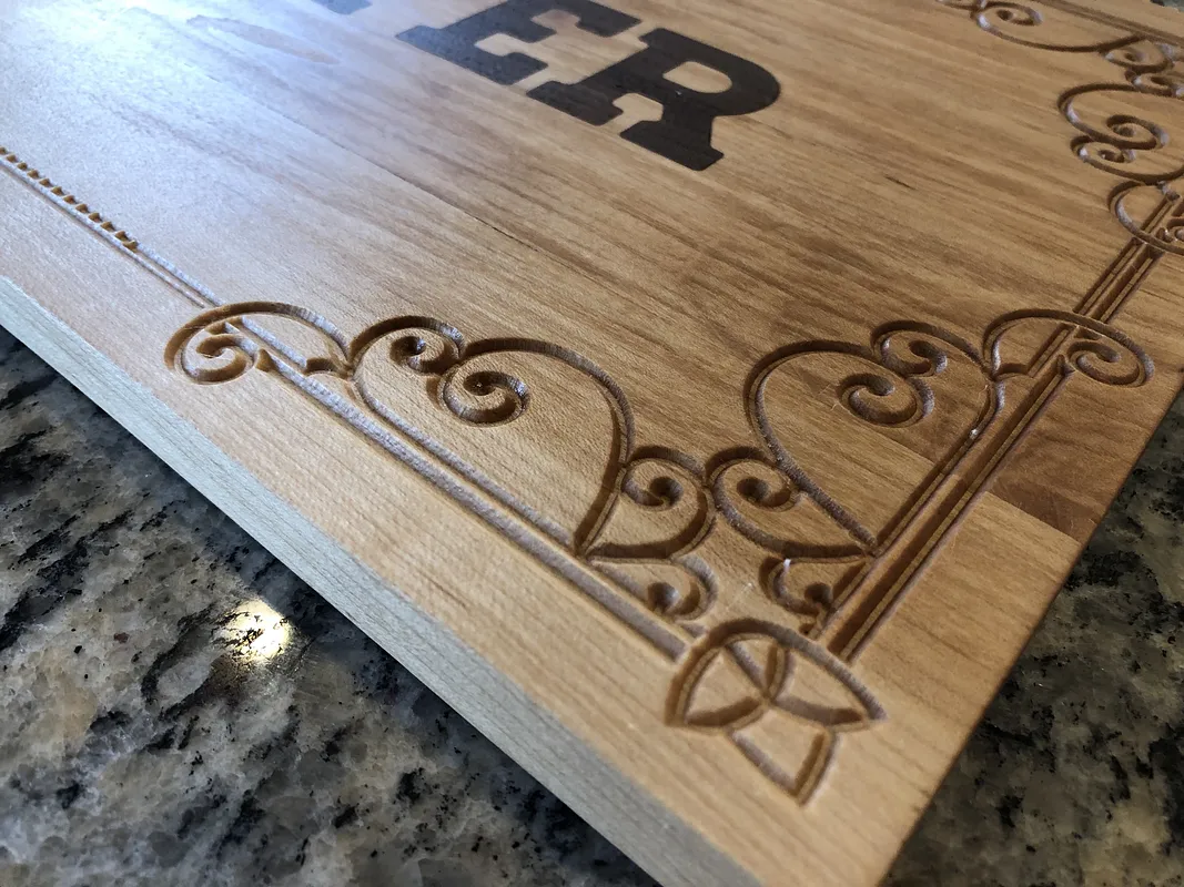

Put the inlay in
Apply some wood glue into the pocket, and then start placing letters in. I placed a piece of scrap wood over the letters and hammered them in to get a tight fit. The scrap wood allows the hammer to apply even pressure across the surface of the letter, and prevent you from marring the surface of the wood. Wait for the glue to dry before proceeding to the next step.
Estimated time: 5 minutes
Sand
Since the pocket is only 0.1" deep, and the walnut inlay is 0.125" thick, the walnut will be raised above the surface. This is ok, because now we will sand the top down to even it up. The result is a smooth surface that feels like the same piece of wood, other than the color.

Finish
To protect the wood and give it a beautiful color, I applied Howards Cutting Board oil and conditioner. This is a food safe mineral oil, and the conditioner also contains beeswax and carnauba wax. Although most will use this as a decorative board only, you could use this for chopping as well.
