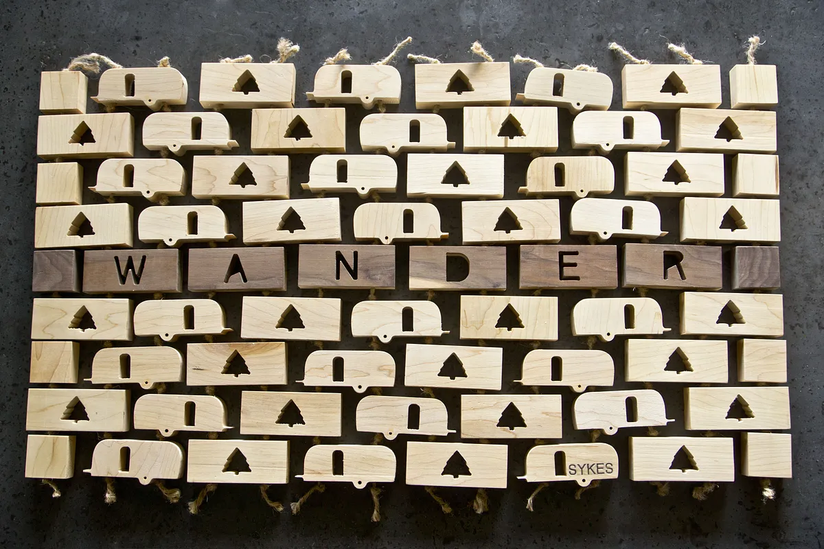

Steps for wood mat
Steps to complete project:

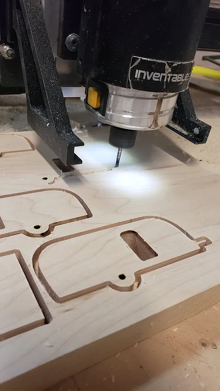

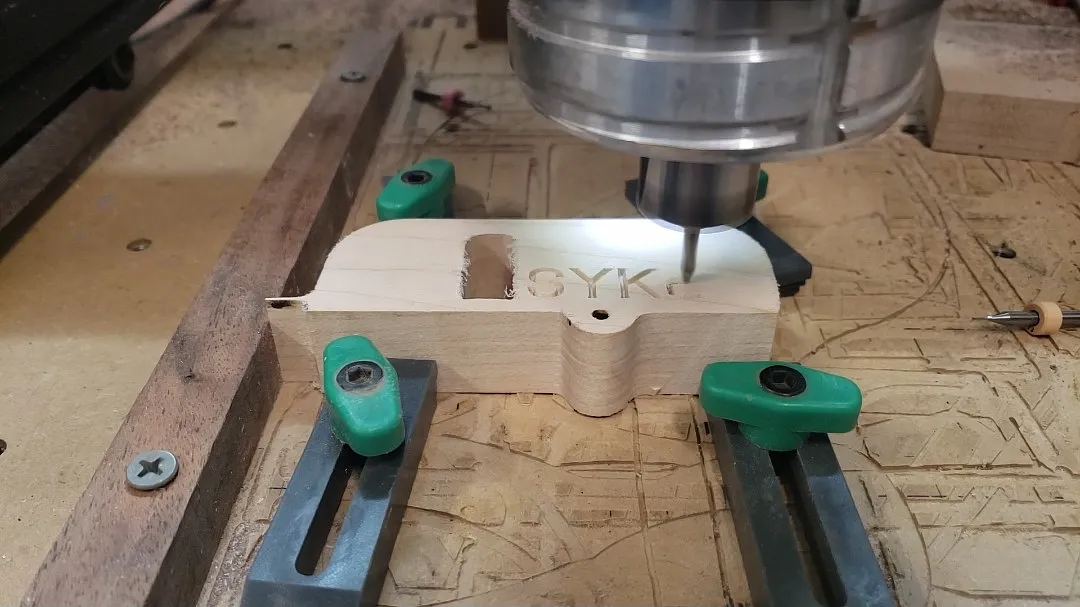

Cut out project using Easel Using a 1/4" drill bit, drill two holes per piece (equal spacing for each hole) through the sides of each cut out block Use 1/8 or 3/16 string and feed through drilled holes, tying a knot on the end of each string and a knot between each piece. Use a clear coat spray can to protect the wood Your done!
