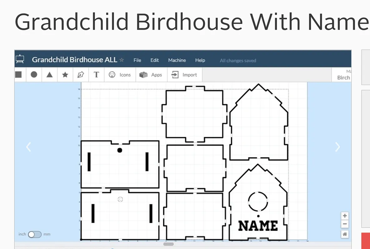

PLEASE REMEMBER You can use any wood you have, but BE SURE TO Adjust the slot openings to the thickness of wood you are using!

Cut it twice, unable to have it fit

Arthur, what thickness of wood did you use? As I remember, I used 1/4” plywood. One has to reset the slot widths on the bottom pieces to match the wood thickness.. I made about half a dozen with this pattern, and they all worked. I wish you well. God Bless, Martin

Hello. I am thinking of building this for my grandkids. Do you have a finished image?

My nephew sent pictures, I will see if I can find them?
