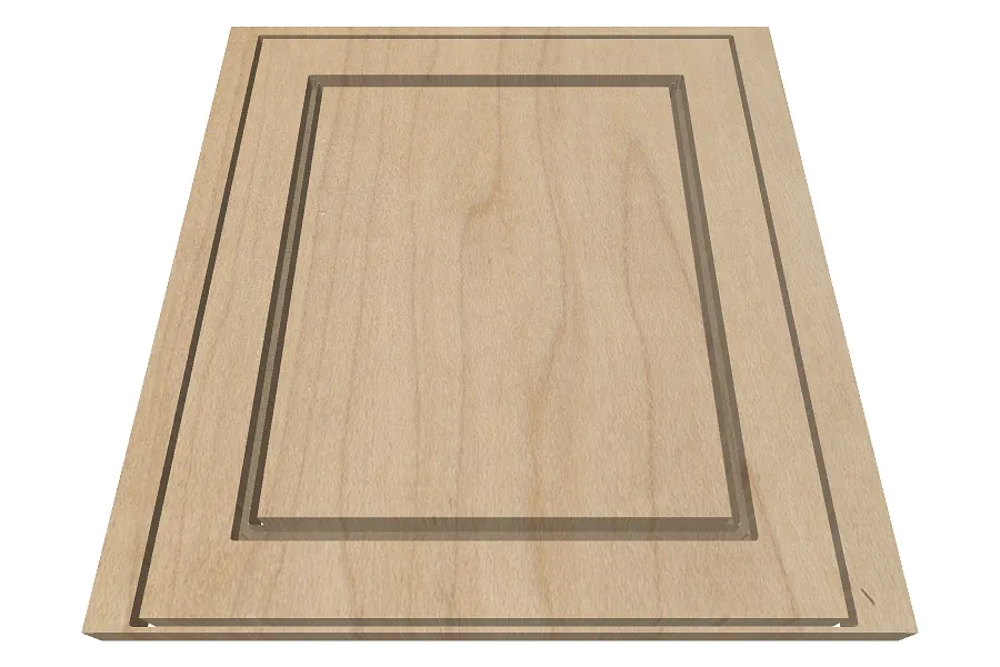

This needs to be cut from the back side. Adjust the depth of the picture nest area according to your glass and backing thickness. When done, I either flip it and add a border to the front or put a nice edge on the front with my table router. Makes a nice frame.
Yora SilverBack Benchtop CNC 6060
Hard Maple
