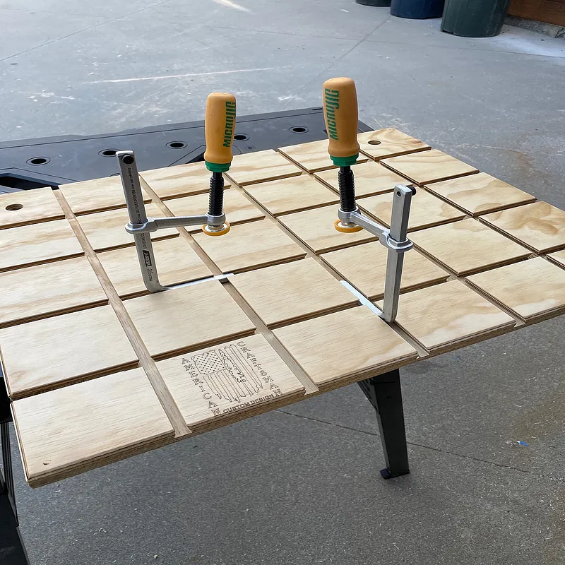

This is for the Microjig system, this requires the Microjig dovetail bit as the bit is different than a standard dovetail bit. I used 3/4" Birch Plywood.

The tool paths are made to extend beyond the material to ensure a proper tool path. The holes were drilled afterwards to match my table.
