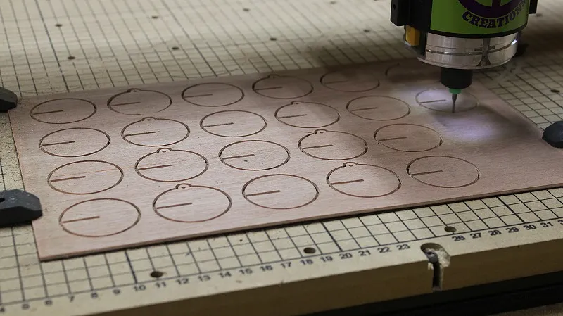

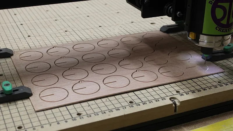

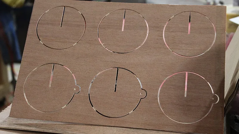

You'll find the thickness of my material in the Easel file is .089" and this is the actual thickness of the material I purchased, even though it's called 1/8th inch Luan (but is does state in the paperwork that it's 2.7mm).
I cut out each size of ornament in 8" x 12" sheet because this is how I sell the ornaments to do-it-yourself crafters in my area. Feel free to expand the project onto 30" x 30" sheets (if you have a 1000mm -Carve).
The 1/8" Luan plywood used to commonly be referred to as "door skins" because this is what is used to make interior hollow doors. It costs me $11.75 (US) per sheet at my local lumber yard

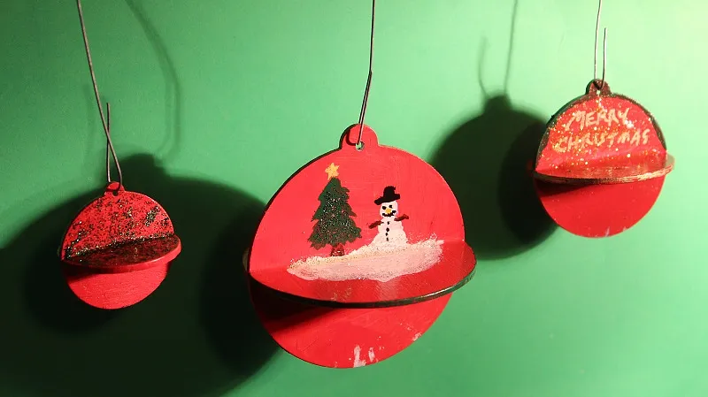

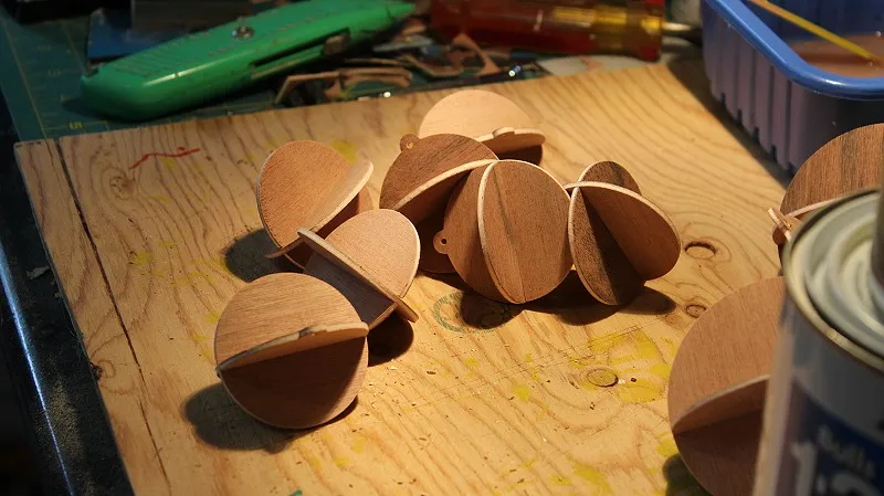

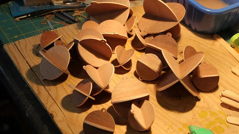

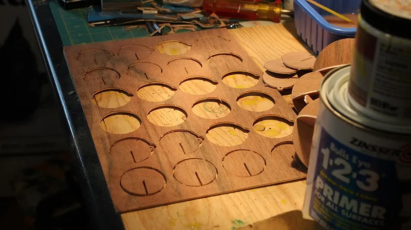

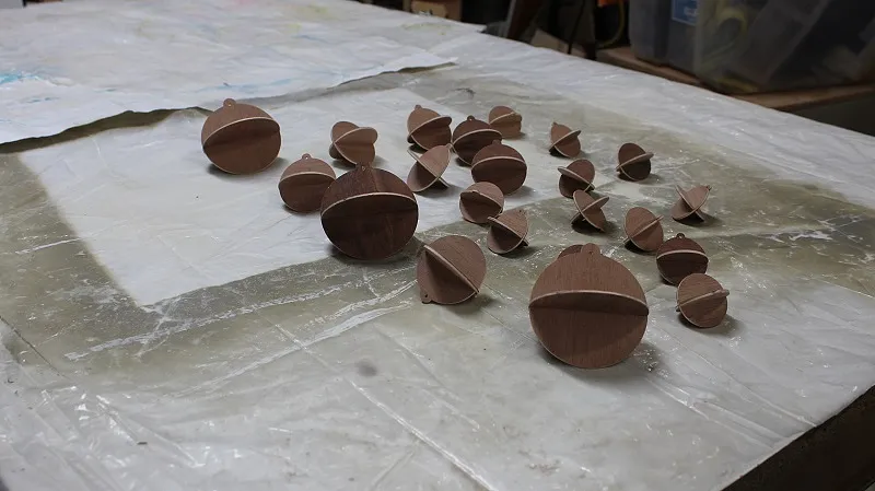

Remove parts from the plywood sheet, and assemble the two parts. The slot is .090" so the parts fit fairly snug (may need a few love taps), and does not need any glue.
Sand, prime, paint/decorate. Hang on tree. Done!
