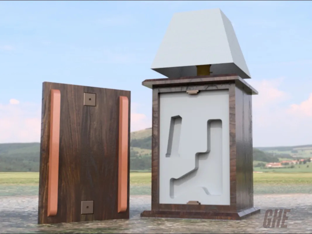

CL-100 Board 1 CONTOURS
My first X-Carve Project!!!
0.5" MDF, 24" x 24" Sheet, x2 Sheets Required. Sheet 1 of 2, ToolPath Set 2 of 2. 0.125" Bit Size.
o Cut part contours Through All (0.5" Tabbed, OUTSIDE). o Cut square spot faces to 0.05" (Inside, FILL). o Cut x2 Holes Through All (Inside, FILL).
MDF
