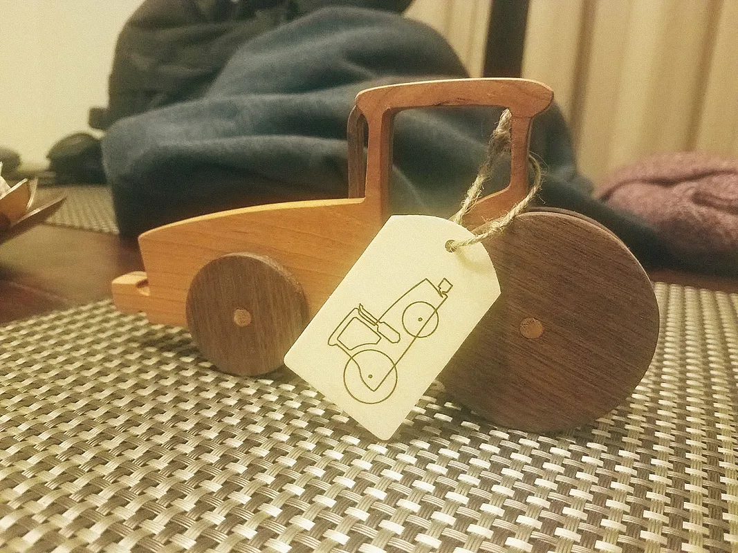

So, like I mentioned in the project overview, while making this, I wanted to utilize the materials that I already had available. You'll see in the project materials I've selected some cherry and walnut project pieces, but you can do this with pretty much any wood and the thicknesses are totally up to you.
For mine I plied a piece of cherry and a piece of walnut for the tractor body, walnut for the wheels and 1/4" red oak dowels for the axles and mounting the exhaust to the body.

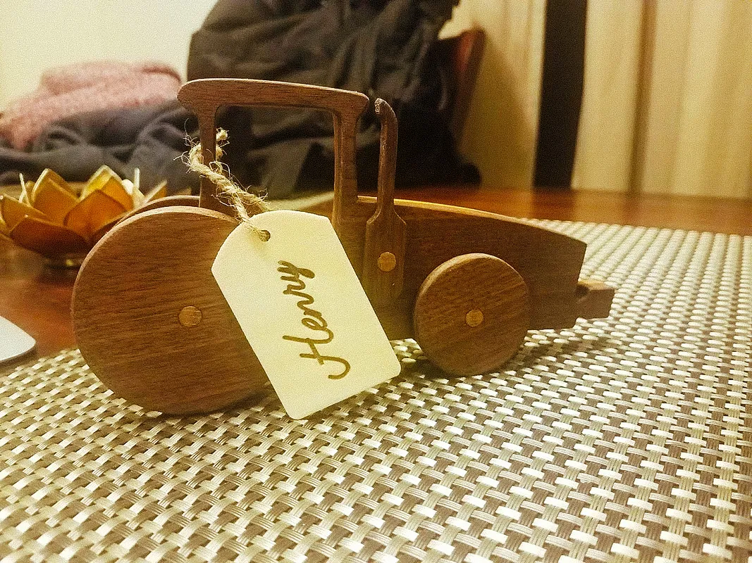

After all that I just picked a good spot close to the cab for my exhaust pipe. You'll see that I technically put my pipe on backwards. Shit happens... If you wanted, you can drill this all the way through, but I just went in deep enough that the overall dowel length was over double the thickness of the exhaust piece. That's why you can only see the dowel when looking at the side with the pipe.
With a drop of wood glue, mount one wheel to each axle, pass the axle through the body, glue the other wheel to the axle and use a small hammer or block of wood to finish the dowel joinery. Cut off or sand the excess dowels.

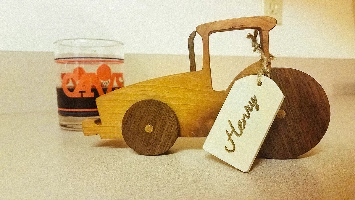

For mine I used one coat of satin polyurethane. For something like this I think I'd typically recommend using a natural finish though. You never know what little kids are going to taste test, and it's always best to play it safe. Use something you like. Hindsight, I think I would have used a butcher block finish like the ones that contain beeswax and mineral oil.
Get your farm on
In the picture above you'll see I just ran off a blank tag with 1/8" Baltic birch (courtesy of Mo's gift tag project), laser engraved the name tag, and tied up with some jute twine.
This project is pretty simple, but open-ended since I didn't really use standard-size materials. If you decide you want to make one of these, I'd be curious to see what kind of materials and thicknesses you went with. This body is half cherry, half walnut with oak dowels. You can run off a number of body pieces and ply them together to create a wider tractor, same for the wheels. You could also go with beefier dowels to make the axles more sturdy or add two extra rear wheels like the real tractor.
