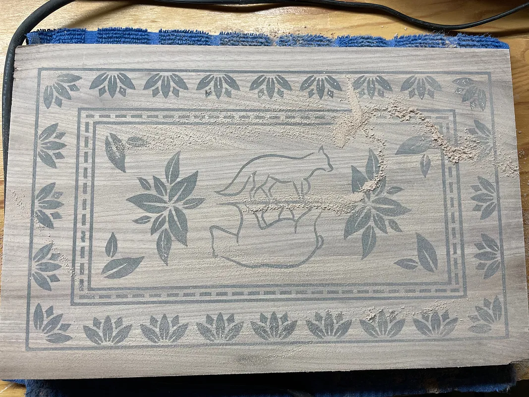

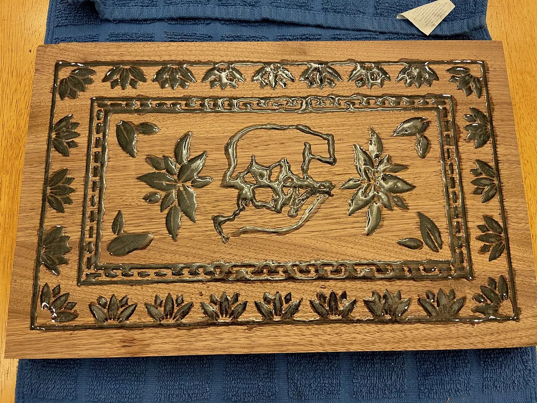

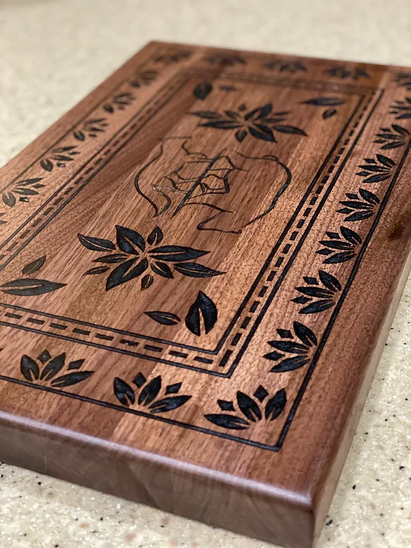

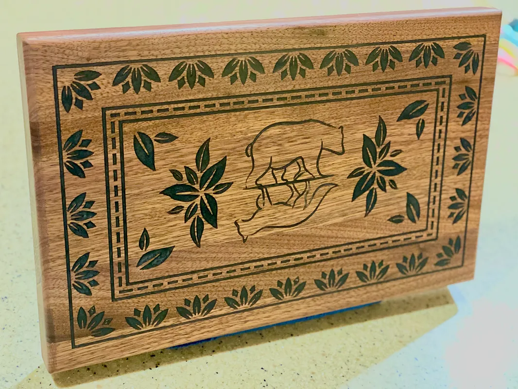

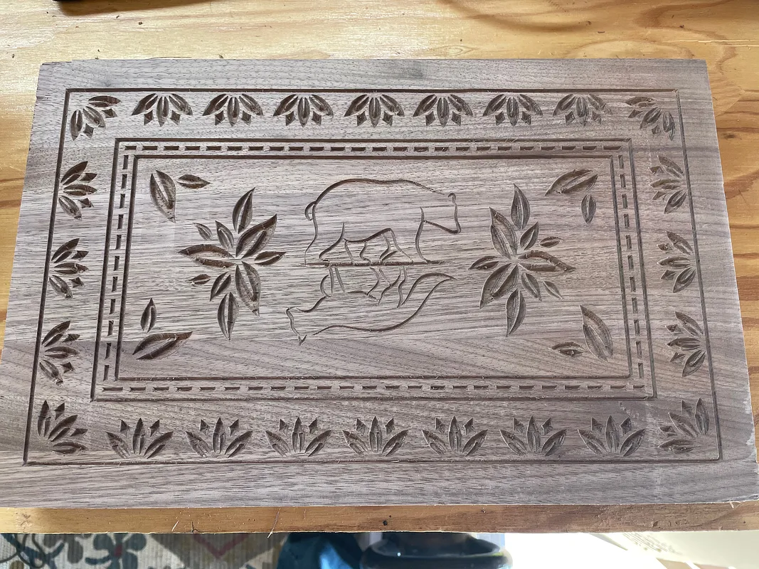

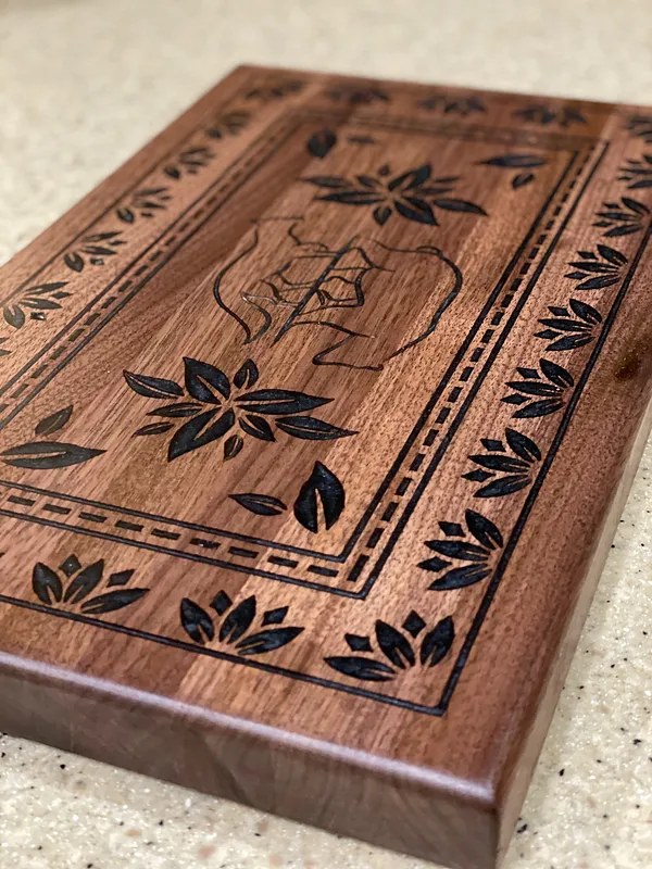

Nature cutting board designed entirely in Easel using basic shapes and the pro design library. Walnut wood carved with a 60 degree v-bit and filled with a black pearl epoxy inlay, then a wax/mineral oil rub.

That is a beautiful project. Nice Job
