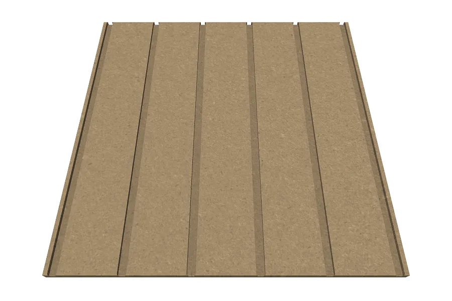

I adjusted my machine to 30" x 30". Moved the Home to the very far front left corner, as far as the machine can physically go. Zero is now about 1/4" right and back of the first bolt in the front left. I used a 1/4 Spektra Down cut bit (46202-K). I finished the path off the waste board by setting up 2 identical boards, 1 o neach side of the new channels ans using the T-track as a guide , I used double sided tape to hold them down. then used a 3/8" end mill with a bearing to finish out the rest of the channels. Assuming there at now obstacles, it should be quick and easy.
