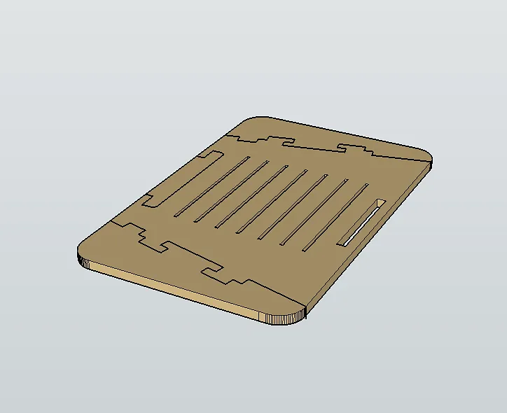

For this project we need a piece of bamboo plywood that's at least 20 inches long x 12 inches tall, 3/8 inch thick.

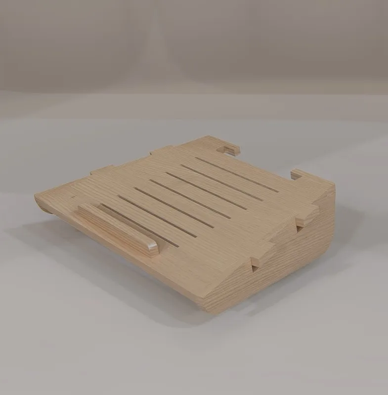

Since it's plywood and we don't really need to sand the faces, the only part we want to sand is the edges.
Once it's all sanded down, we choose a finish. In this case I'd rather go for several coats of polyurethane, since this piece will be moved around alot and I wouldn't want it to get scratched up that easily.

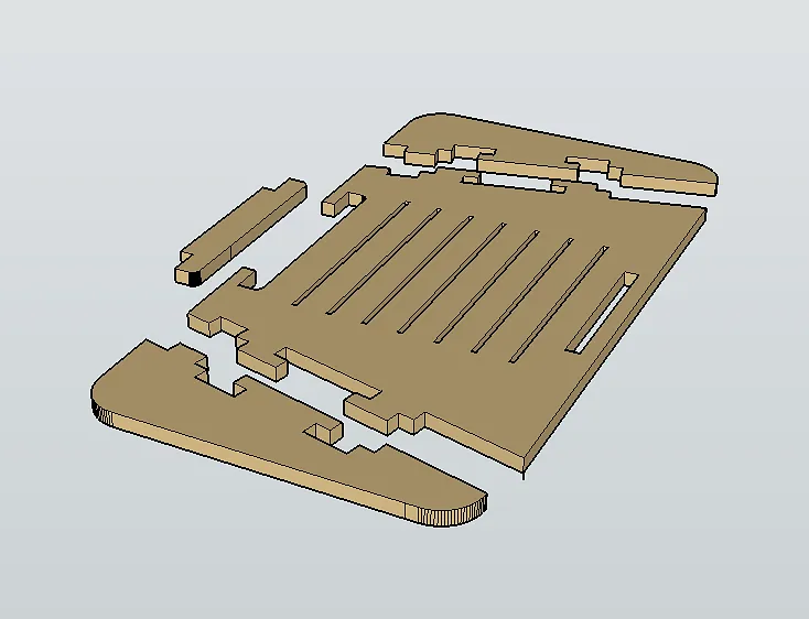

Great job! Did you design this in easel? I tried making it out of 1/2” ply but forgot to adjust the dimensions accordingly so it didn’t fit together in the end ! Live and learn.
